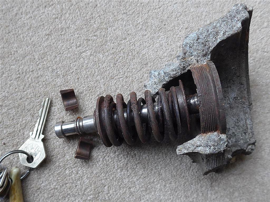

I just happen to have a valve from a Griffon that may be slightly but not dramatically bigger just to show you the size of the "reduced collet section" that fractured.
