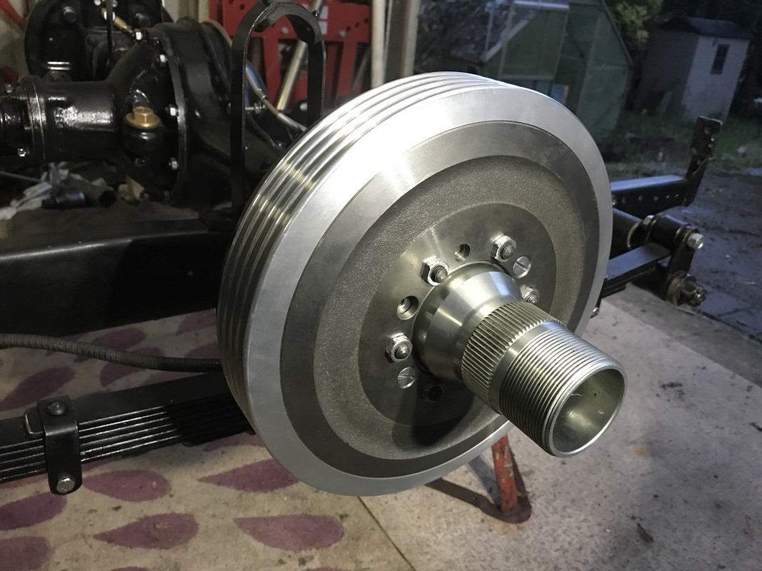

With my new braking system I have tried to keep appearances traditional by fitting "Alfin" type brake drums. TC racing enthusiast, Peter Edney (yes, the guy who had that disastrous fire) has developed special brake shoes using Mintex halo material to give improved performance without losing feel at slower "around town" speeds. These shoes are both bonded AND riveted.
I might add that the investment has been substantial.
