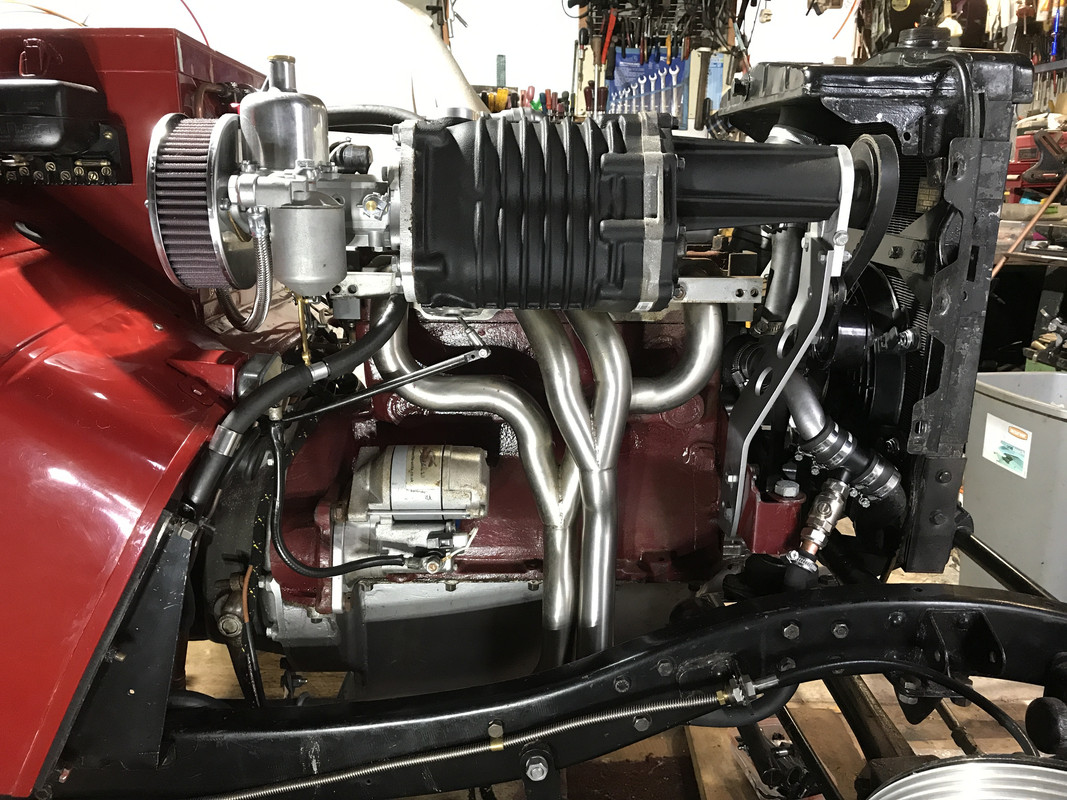

I have been looking for a new or refurbished SU carb; in particular the H4... but Burlen, my first port of call, seems to be out of stock and I have had no luck in searching the 'net at all.
I want to find a single 1 1/2" H4 with the original style choke and a banjo type fitting to the float chamber.
The reason I am looking for this particular carb is that the Eaton M45 supercharger that I have fitted to the MG TC has a 1 3/4" H6 which, at the time , I was advised by the supplier would be ideal for my engine.
I have since discovered that for a 1300cc engine - even modified with the fast road cam and tuned head with bigger inlet valves, like mine - the 1 1/2" carb - which it would normally have had - would still be the better option.
What concerns me is that I have been told by a hot rod supercharger guy in the States that the bigger carb could both reduce torque and MPG... but I don't know if that is the case or not.
I thought perhaps if I had a choice of carbs and experimented with different needles I might stand a chance of getting optimum performance from the engine.
Any ideas??

Good to have your input Peter. You are right that I want (if I can find it) a vertical one; a slightly smaller version of what is already fitted. The body on my carb extends sideways and I don't know what difference it might make to the running. What I do know is that a carb with a shorter body will cause me difficulties in positioning the choke cable; it would need to be changed and I am fast running out of options..
As the supercharger is a modern design and specifically adapted for the XPAG engine, I can only imagine the H4 carb was chosen as the best option available.
( I wonder if the reason the supplier enthused about the HS6 was a shortage of the correct carbs? ) Confused
