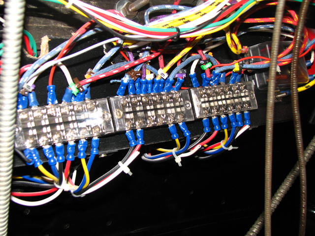

I am trying to avoid this... which while it does the job is not the prettiest or most convenient solution.
I will look for something more substantial.

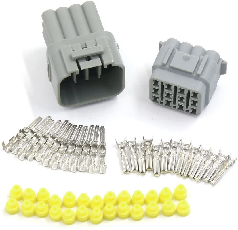

Something like this perhaps?
MVPeters
Joined: 28 Aug 2008
Posts: 822
Location: Northern MA, USA
PostPosted: Sun Jan 02, 2022 8:28 pm    Post subject: Reply with quote
Yes, they look a bit better.
