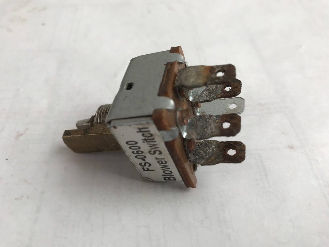

PostPosted: Sat Feb 05, 2022 8:13 pm    Post subject: Alarming corrosion! Reply with quote
This is a fairly new switch that I fitted a few months ago. It was connected but has never been used. When I had difficulty in removing the spade connectors I thought something must be amis. What I hadn't expected to find was such an alarming degree of corrosion. Interestingly, the one terminal that had not been connected seems to be unaffected.
I presume it is some kind of galvanic reaction with the terminal fittings ... but I don't really know what causes it. I have ordered a new switch but will be sure to use some petroleum jelly or suchlike to try and prevent it happening again.
I just thought fellow contributors might be interested.

PostPosted: Sun Feb 06, 2022 4:07 am    Post subject: Reply with quote
If this has been fitted to your MG then it's alarming indeed, but whatever it's fitted to it shouldn't corrode like that over a few months - something is sadly wrong here. It should take years of use in a notably harsh environment to get to that state, IMHO.

PostPosted: Sun Feb 06, 2022 5:25 am    Post subject: Reply with quote
An astounding and alarming thing to happen. I have fitted battery cut-outs on my two cars for years and have not suffered. I assume your battery must have been connected?
Posts: 7225
PostPosted: Sun Feb 06, 2022 7:33 am    Post subject: Reply with quote
The incredible thing is that the battery is NOT connected!. I have never seen anything quite like this before but the worrying thing is that I don't know if it is the switch or the terminals to blame.

PostPosted: Sun Feb 06, 2022 9:38 am    Post subject: Reply with quote
I’ll wager that the female connector is brass?
Posts: 7225
PostPosted: Sun Feb 06, 2022 10:15 am    Post subject: Reply with quote
Yes Dave. They are brass. I think they came with the switch.
What should they be?
Posts: 4272
PostPosted: Sun Feb 06, 2022 11:25 am    Post subject: Reply with quote

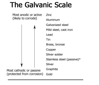

Ideally both parts of the connector should be the same material, the contacts on the switch look to be zinc plated, zinc and copper are at different ends of the galvanic order, hence will corrode. That said the speed and amount of corrosion on your switch is quite shocking. The combination of different metals in vehicle electrical connections is not uncommon, but they don’t usually corrode like that, especially as I presume the car is stored in a dry location.

Posts: 2132
PostPosted: Sun Feb 06, 2022 1:12 pm    Post subject: Reply with quote
Some modern electrical connectors seem to be aluminium as well.

PostPosted: Sun Feb 06, 2022 6:33 pm    Post subject: Reply with quote
I think there must have been a lot of complaints about this particular switch (FS0600) because they used to be everywhere but now seem to have all but disappeared from sale.!!
I have ordered a replacement from 'Car Builder Solutions' from whom I bought the heater originally but will not be using brass connectors again!
I haven't raised the corrosion issue with CBS because they would only ask me to return it ...and I have modified the shaft by filing it down to take a brass terminal block to which I have fitted my own matching control knob.
