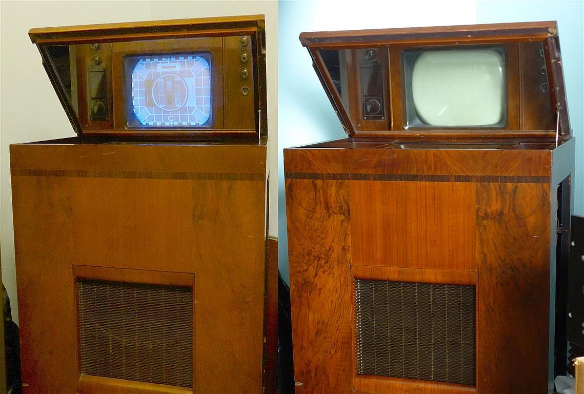

Posts: 7225
PostPosted: Sun Jun 30, 2024 4:10 pm    Post subject: Reply with quote
I've been using boiled linseed oil for years on my old car and also my old television. It really brings out the figuring of the wood on old French polished items.

Posts: 7225
PostPosted: Mon Jul 01, 2024 9:03 pm    Post subject: Reply with quote
No, it hardens with time. It doesn't take long to just have the feel of the original.
