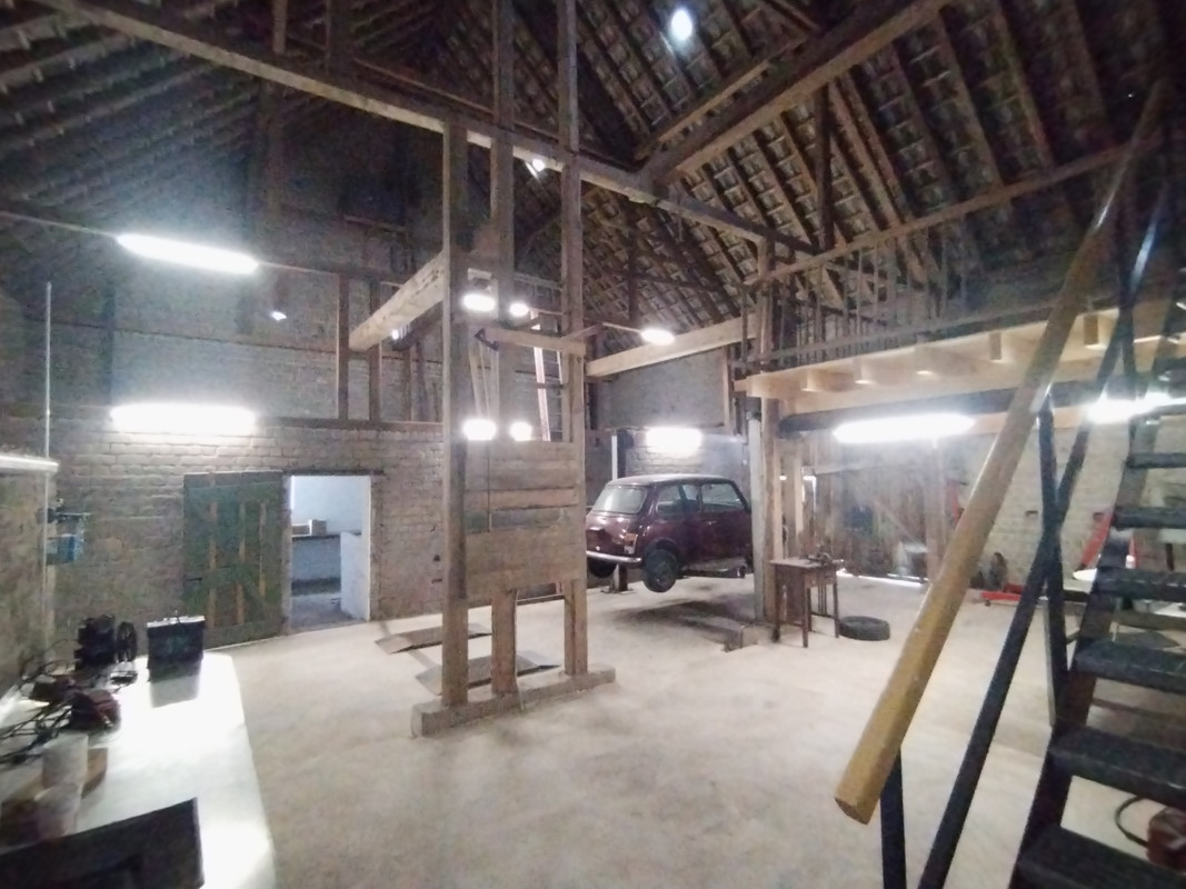

This is the main barn of the U-shaped farm. Not as charmful as a "Fachhallenhaus", but no comparison to as it was two years ago:-)
Next to it is a former pigsty (housing the lathe, tyre changer+wheel balancer, sand blaster and other bigger machinery), a smaller barn and a row of garages with a second floor for storage space. And if course the residential building.
Until I found this neglected farm, my stuff was spread over 4 different places so I am really happy to bring it all together over the next years.

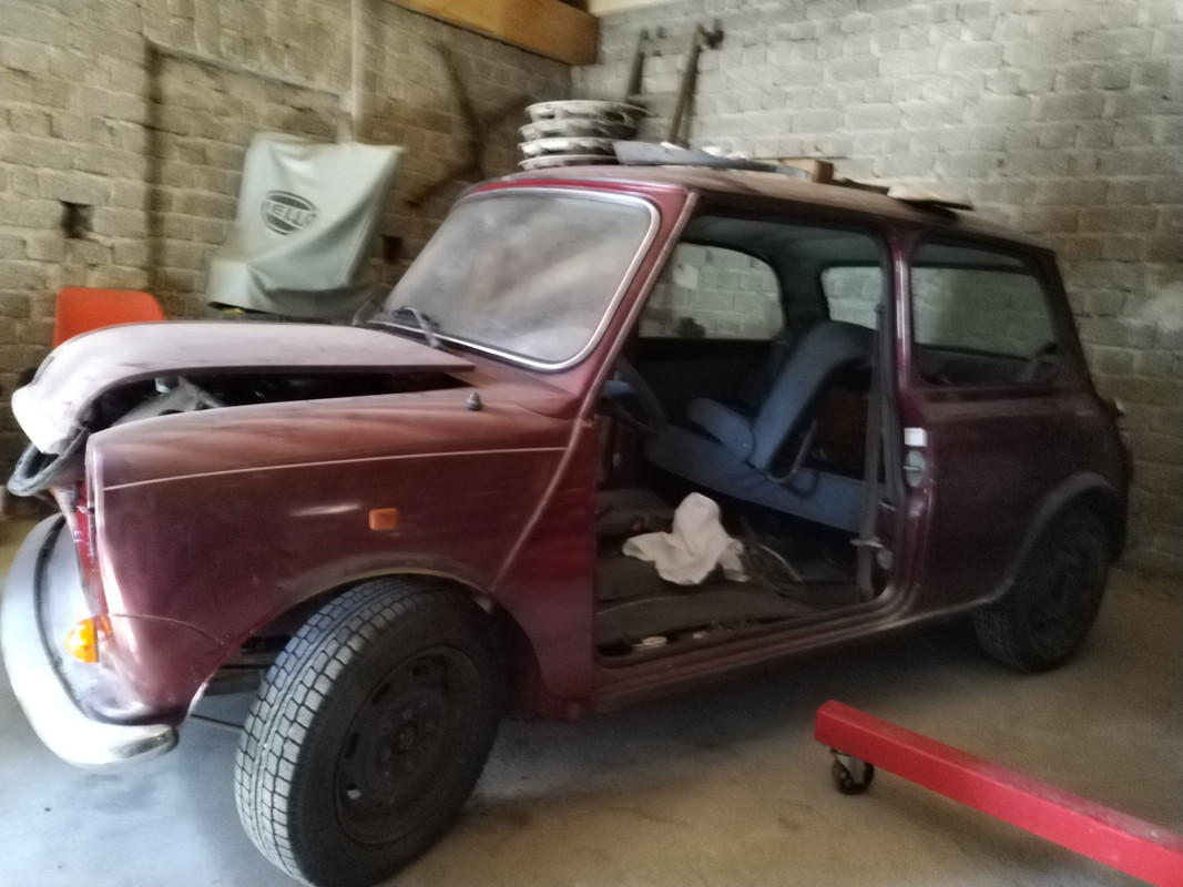

Today I moved all cars out for a good clean up of the barn and then carried on with the recommissioning of the Mini Mayfair. I will try to have it finished until spring, as I plan to attend the International Mini Meeting 2024 with this one. [/b]

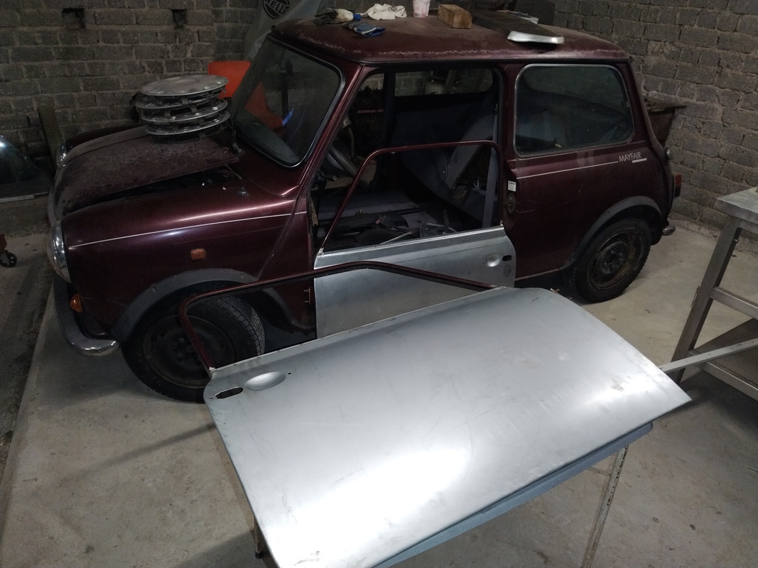

Around a month ago I equipped the Mayfair with new sills, new door skins, a panels and some patches here and there:

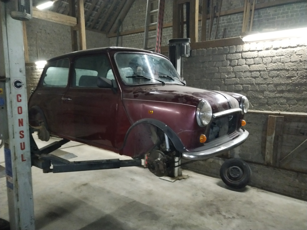

Today then I renewed the diff output oil seals, the bushes of the tie rods and the lower arms, fitted new brake discs/pads and Kayaba shocks all round. Happily all the parts were still on stock.

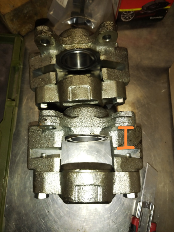

On stock were also two new brake calipers I purchased a few years ago at a well known mini parts dealer in England. Unfortunately the offset for the brake disc clearance was 4mm different to the original ones, so I couldn't fit them without touching the brake discs. I then refurbished the original ones, what ruined my schedule for today. Laughing
I also didn't have a replacement for the disintegrated steering rack gaiters so couldn't finish the front suspension. I will order new ones and hope to find motivation to fit them as well as new rear brakes the next weekend.

The last week I refurbished the rear suspension and the rear brakes of the Mayfair, fitted new steering rack gaiters and changed the oil and filters.
So from the underside now everything except the exhaust mountings is done. I ordered a few missing parts at Minispares today and hope to receive these the next two weeks.

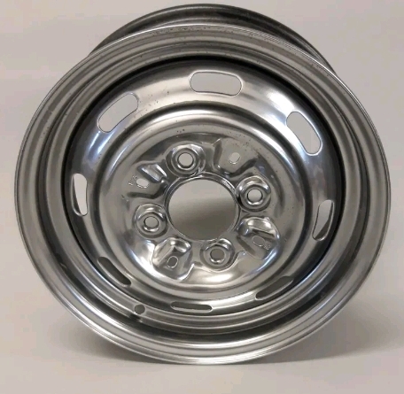

Yesterday I also fitted a new set of tyres on some chrome style finished NOS Dunlop original stell rims. I bought these rims last year cheaply from another local mini ehtusiast.
These were sold originaly in the nineties and noughties under the name "Metallica" by MiniMania. In Germany it is only allowed to mount "TUV" -approved rims. As most of the aluminum rims on the market don't have this approval Mini Mania reworked new original steel rims to make it look a little bit like aluminum ones.
I am still not sure if I really like this (blingbling) look, but they are maybe a little bit better than the rusty original ones.

The steel wheels are probably lighter than the alloys anyway.
