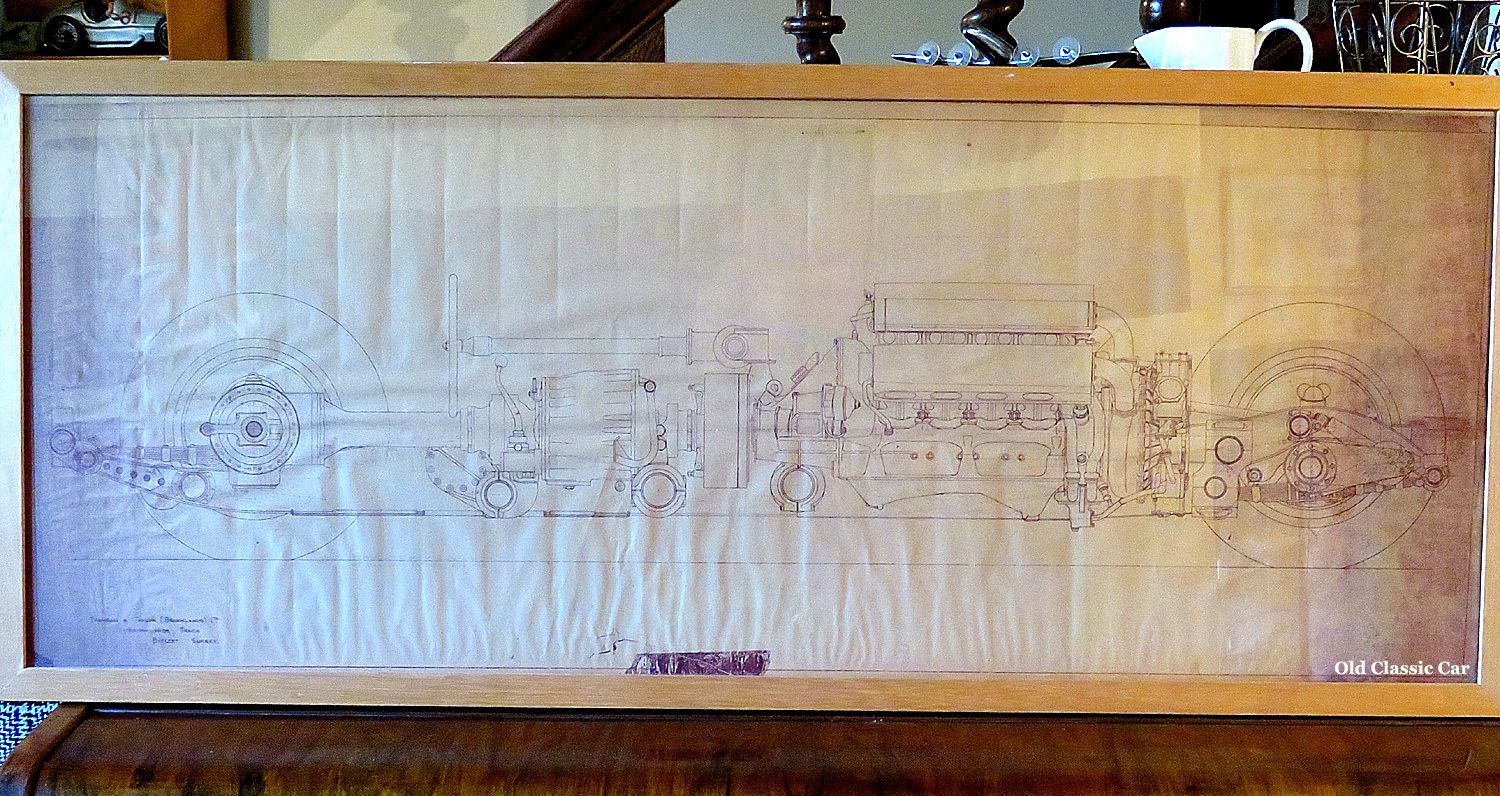

Can anyone help id the car represented in the drawing below?
It's a sizeable blueprint, and very tricky to photograph in its glazed frame (hence the many reflections). In the lower left corner it's credited to Thomson & Taylor (Brooklands) Ltd, Brooklands Track, Byfleet Surrey, a company that was involved in the build of various Land Speed Record cars at the circuit, in the vintage era.
In faint handwritten ink it says "Reproduced by kind permission of Thomson & Taylors Aug 1970" - has anyone seen this before? Was the drawing reproduced in numbers to sell, say at Brooklands, or in a magazine, or elsewhere? The chap I bought it from didn't know much about it, other than it belonged previously to someone that had worked on the car shown - but what car/vehicle is it? and is it even LSR related, or something more mundane entirely?
Apologies for the horizontal scrolling required, but to shrink it too far would reduce the visible details.

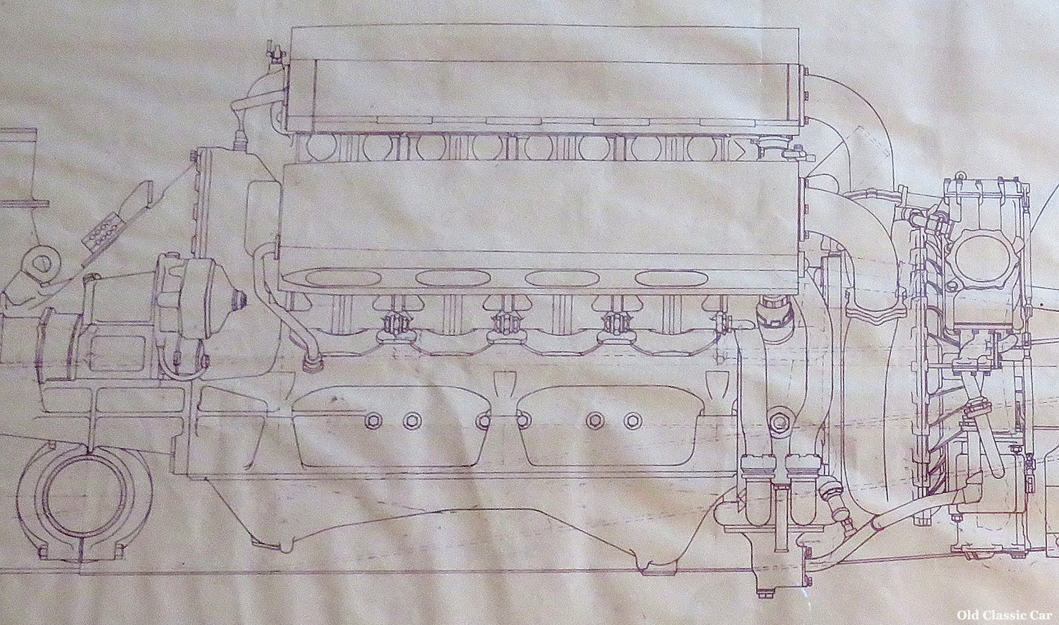

A closer look at the engine:

It is very low with the driver alongside the rear wheel and a relatively long bonnet.
Short slightly cranked gear lever visible and a vertical steering wheel behind the gear lever.
Have you seen what sort of cars they built?
https://en.wikipedia.org/wiki/Thomson_%26_Taylor#Notable_cars
t could be one of the Bluebirds the Napier and ERA look to tall and the Railton Special is driven from in front of the engine.
The engine could be a W12 _________________ Bristols should always come in pairs.

I think it might be Malcolm Campbell's Bluebird that used the Napier Lion engine in 1931 before he transferred to using Rolls Royce engines. In this car he took the record to 246.088mph.

https://www.speedace.info/golden_arrow.htm
Before Bluebird there was the Golden Arrow (1929)which resides at the NMM. When I was just a lad, I visited what was then the Montague Motor Museum. It was not the big attraction that it is today and Lord Montague was always pleased to show visitors around personally.
