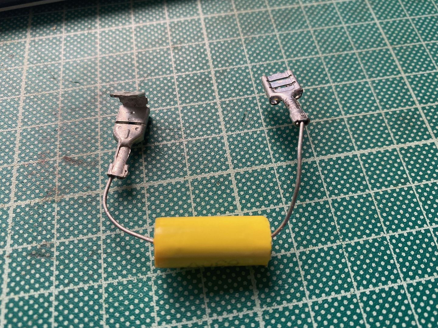

Part of my toolkit is a suitable sized capacitor that can simply and quickly be put across the coil in the event of a condenser failure.
As condensers inevitably fail open circuit this can be added without any dismantling or even having to open the distributor. I have another that has croc clips rather than spades that can be clipped on to coils that don't have spade terminals, thus far I must have given about half a dozen away to folk with problems at shows!
