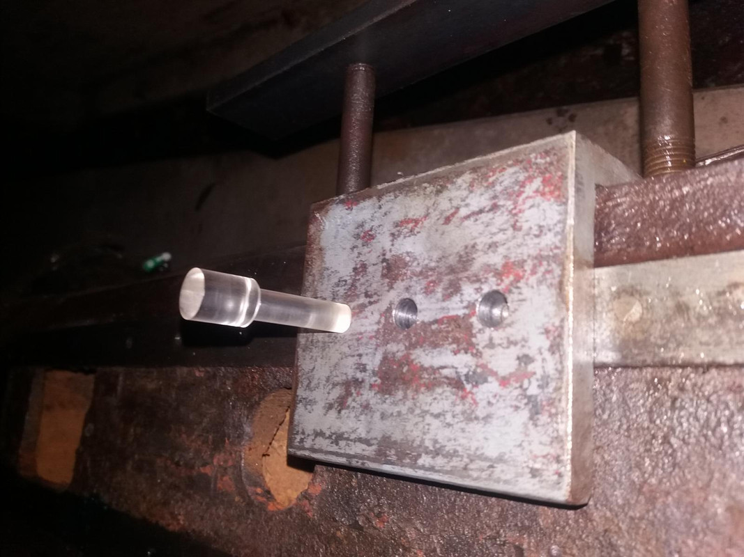

I decided to drill out the broken M6 bolts and install helicoils. This has been a exercise in precision drilling. I made up a little guide or jig to locate the drill on centre in the broken bolts.
My jig has worked pretty well but this type of job it is always a risky undertaking and one never knows what the final outcome will be. At least I can say that I tried something, the other alternative was to junk the engine

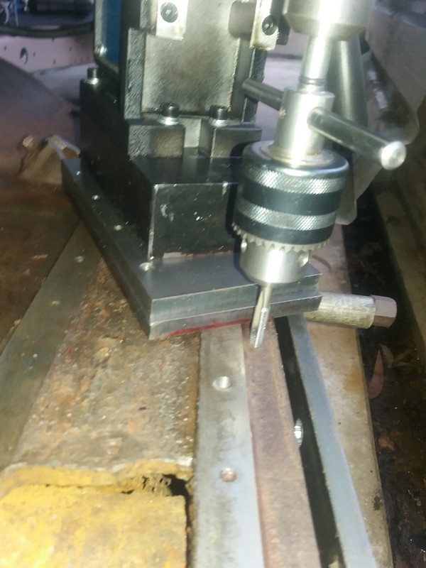

Very important: Use sharp drills and drill in .5mm steps . I begin with a centre or spot drill , then I go to a 4mm drill and continue up to the 6.3mm drill that is supplied in the heli-coil kit.
The heli-coil tap will last for about ten holes, you then need to sharpen the cutting edges of the tap with a small curved honing stone OR buy a new tap. You will risk breaking a tap if you use a dull tap.
I used a cheap mag-drill , the drill needs to be accurately aligned and straight. I made a little jig that accepts a optical aligner , it has cross hairs. After centreing the 8mm optical device, I use a 8mm precision gauge in the drill chuck to align the drill in the hole.
The original holes drilled by Morris Motors factory are slightly out of alignment: by as much as .3mm. So I adjust the alignment of the jig by inserting shims behind the face that sits on the engine top.
The alignment jig needs to be fixed firmly , if it moves around it will result in misalignment of the drill. I made up a bar that is drilled to the correct spacing to fit over two of the head studs, this bar clamps down onto the jig.

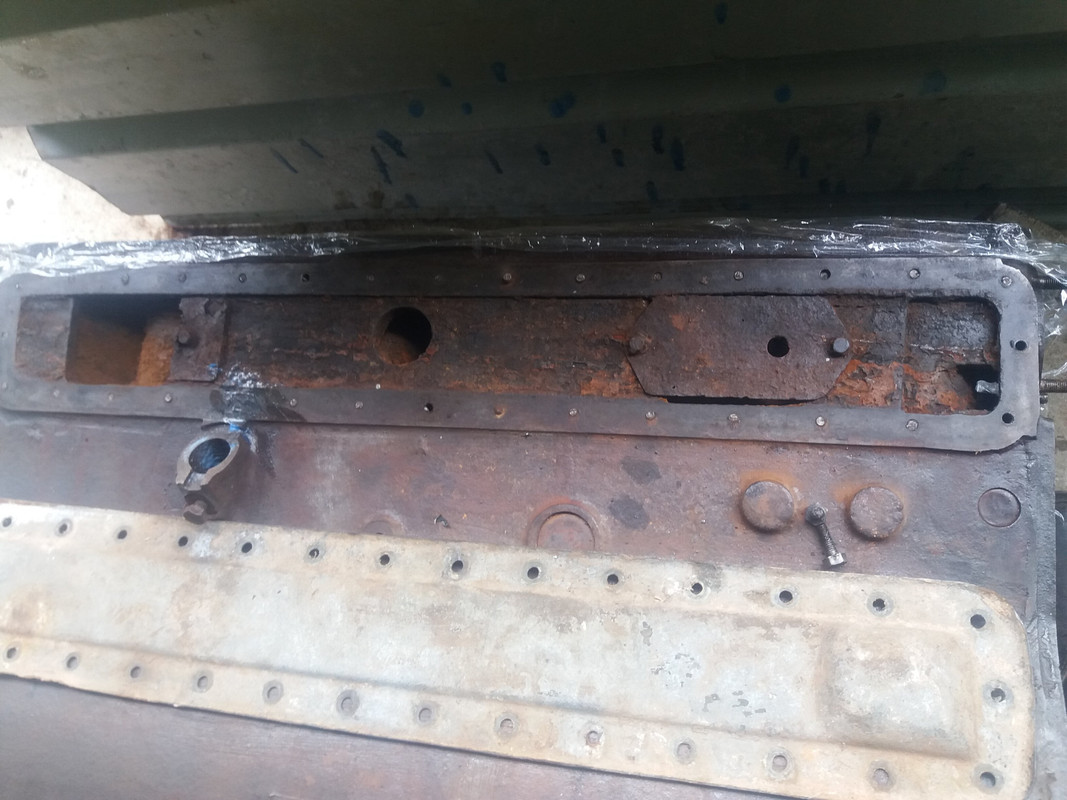

So what I assume you are doing is correctly fitting a cover to the side of the water jacket. I notice that in addition to a round hole there are two rectangular plated holes; one seems to be broken. What are these for, please?

I have not heard of a bolt problem before but the side panel becoming holed by rust is common. one person I know with the same engine in a Wolsely fitted a stainless steel panel.
Yes I am repairing the original threaded holes so that I can fit the original side cover back on.
That is a good question: you ask about the rectangular holes and the rusty covers. The rectangular holes are passages to allow for the coolant to flow into the internals. I think the rusty (broken) covers are placed there to regulate or control the coolant flow. This engine I am working on is a wartime built engine from 1940 , it was fitted to a military CS8 truck.
I also have a earlier civilian engine from a 1937 MCC truck and that engine has the whole of the side exposed or open . I believe they may have had some problems ( may have been stress cracks ) with the completely open side and they redesigned the shape of the side , closed it off, this was done to achieve a overall stronger engine block.

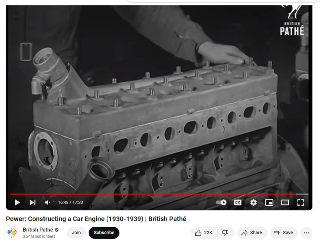

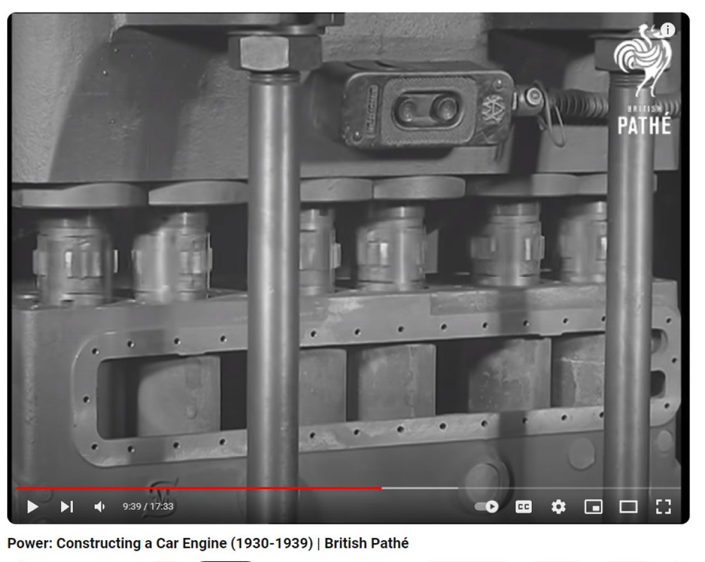

I found a pre-war film made by Morris Motors , it has a few scenes with the Morris 6 engine and how they drilled the 32 side cover holes in one operation !

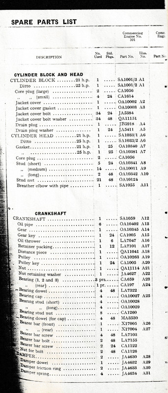

The CS8 engine must be different to the Morris motors Parts catalogue. The head studs usually depend on what is attached to the studs on top of the head e.g. generator mounting bracket.

Yes I can see the three different stud lengths in that list that you attached. Interesting that the 25 sedan used a different head stud arrangement when compared to the Morris-Commercial trucks that had the 25hp engine fitted.

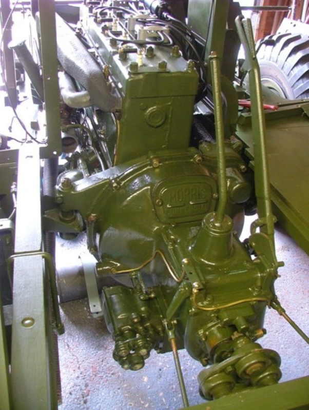

I found a pic of a CS8 engine , a guy in the UK restored a CS8 radio truck. He has fitted some kind of strange ignition lead brackets that I have never seen before ? It might be for a screened ignition system. This is the main page https://www.fareham-darc.co.uk/G8KZO/CS8/CS8.htm
