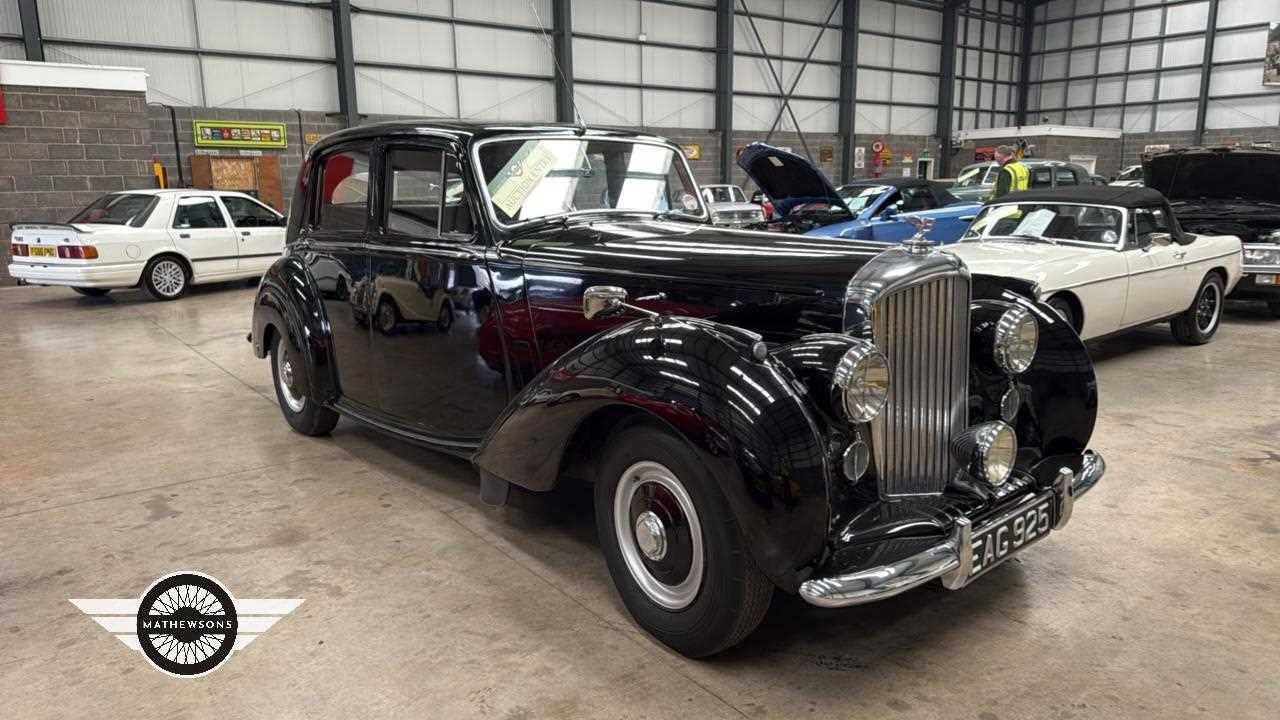

In the video this Bentley engine seems to be making a rather un- Bentley like noise.
https://www.mathewsons.co.uk/auction/lot/lot-784---1952-bentley-mk6/?lot=43615&so=0&st=Bentley&sto=0&au=95&ef=&et=&ic=False&sd=0&pp=48&pn=1&g=1
Any ideas about what exactly we are hearing?
I wouldn't expect a car owned by Derek Mathewson to be a lemon but you just never know.
(I would, however, take the speedo reading with a large pinch of salt.)
It is the noise that this "silent sports car" is making that interests me. If it is something simple then I suspect this could be a good buy.

Sounds to me as if some of the splashy noise is down to the microphone, perhaps?
Also, it has twin tailpipes, so there may be splashiness in the exhaust, due to running on enrichment [cold start?}

Hello Alastair. I think you may be on to something re the exhausts. Despite being quite a big car, the route for the exhaust pipes is tortuous to say the least and they could well be leaking. They may be rotten; who knows.?
A rich mixture, combined with a misfire could make a noise I would have thought.
On the plus side, the engine appears to have good oil pressure. Then again, oil pressure on a cold engine at tick over is not much of an indicator, is it?
One thing that I have discovered about these engines is that sludge build up can be a problem. If the upper oil galleries are blocked, there would be a lot of valve gear clatter.
One owner wrote how he resolved the noise issue by regularly flushing the oil.
Another thought I have had since posting this is that there may not have had any coolant in the engine. In an under bonnet photo a ruptured heater hose can clearly be seen. Without any water the engine would be noisier, wouldn't it?
I suppose the one thing that would put off potential buyers is broken top piston rings. These engines are notorious for this. Some say it is caused by the chromed cuff liners wearing at a different rate to the rest of the bores; resulting is a slight ridge where they meet. The theory is that the top piston ring catches and breaks. My question is why only the top ring; surely all the rings are at equal risk?
Whatever the theory, I would have thought this would make a noise.?
Then again, there didn't seem to be any smoke coming from the exhausts, did there?

I still think a lot of it is down to the quality of the microphone used. Coupled with the building its being flimmed in?
Whilst I do like the 'concept' of the MkVI Bentley as a 'user', the observations around engine issues[and the expense involved in sorting them]....makes me think a half decent scruffy Alvis might be a more useable option?

You hit the nail on the head. I really need to remember all the good advise that I have been given by MkV1 owners who would have done things differently (and seem to have some regrets.)
Buy one that someone else has spent their pension on. They are out there but good examples are few and far between. Nearly all the ones I have seen advertised have been "got at"... and not very well either. Shocked
The Mathewson's car may well be a low mileage example; the body looks excellent which is important as they tend to rust quite badly.
The downside is that while the interior is reasonable (I would put it at no more than that) mechanically it looks to have been neglected for many years....and that is a worry.
