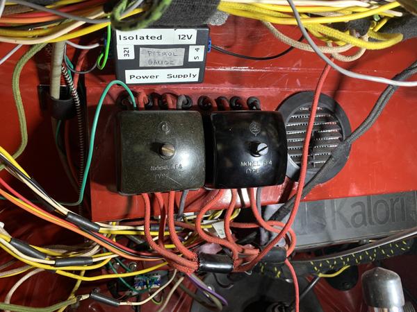

Many - if not most - older cars had just two fuses. I feel unhappy having to rely on a 35 amp fuse blowing in the event of a short circuit.
This is why in addition to the two existing 35 amp fuses (in the RF95 control box) I have tried to protect individual circuits by adding 8 lower rated fuses in my MG TC rewire.
I have also added numerous relays to protect the original (and expensive to replace) dashboard switches.

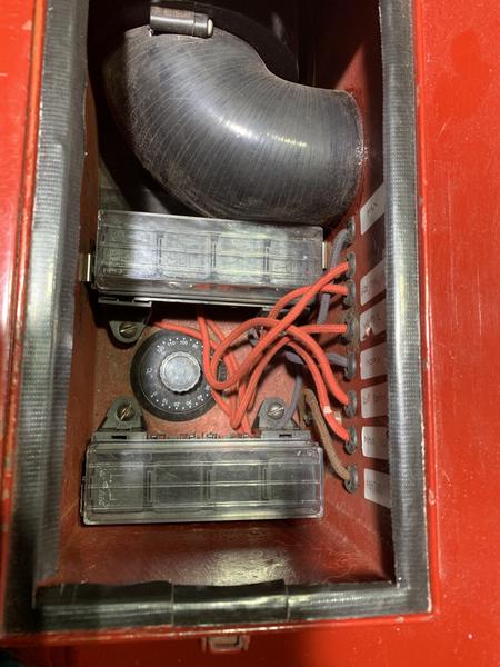

Fortunately, original style fuse boxes are still available.
(Incidentally, the isolated 12 v supply is for the
hydrostatic/electronic petrol gauge which comes
with it's own relays.)
Here the red wires are 12v with the ignition on and the blue ones
are 12v before the ignition switch.
The wires will eventually be tidied up. Very Happy
