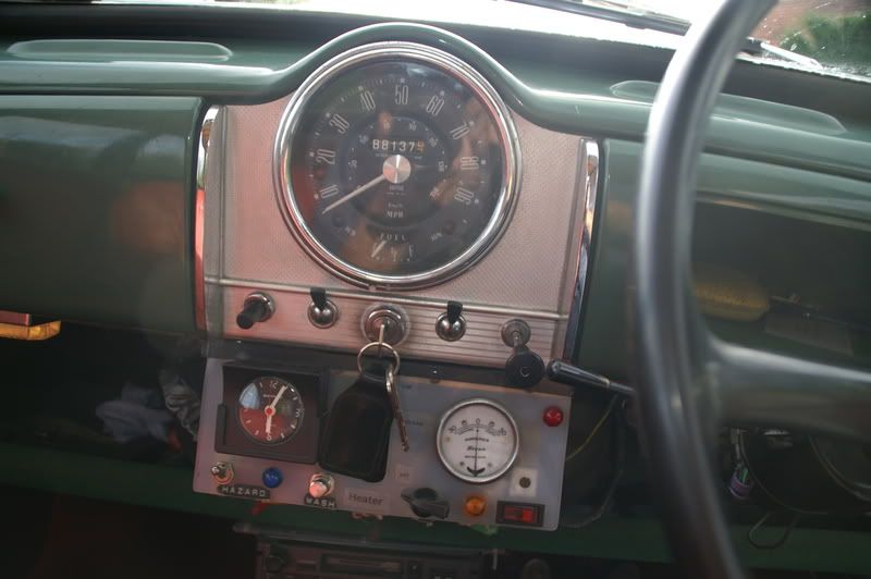

This is what my dad fabricated for his Morris Minor about 25 years ago, hazards have a separate switch and lamp, bottom left on the dash extension, a typical creation from my father who would always put practicality over aesthetics Very Happy
This set up passed many mots.
That looks like the kind of thing I would have been happy with in the 1970s. As I recall, any modification that "improved" my Austin A30 was O.K. at the time.

From memory, the top right red lamp was ?brake lamps? he had a run of repro hydraulic brake lamp switches failing, so added a check lamp!
