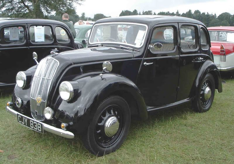

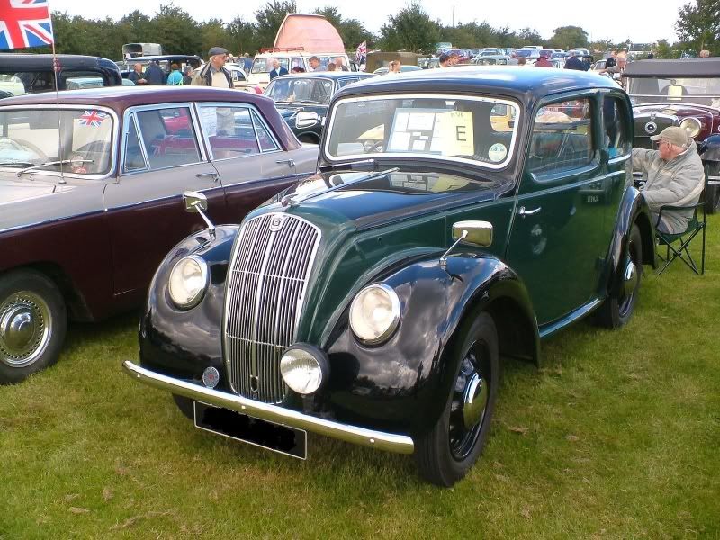

Lucas marketed a kit that upgraded the Series E lamps. The original lamps are quite unusual in that they are oval and rake back in to the wing, very modern for the day not unlike the BMW Mini!
The Lucas conversion enabled you to fit the more standard 7" units, but do nothing for the look of the car (in my opinion!)
Here is the original;
And with the Lucas mod;
Do you see what I mean?
