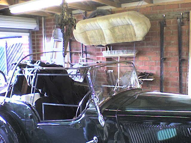

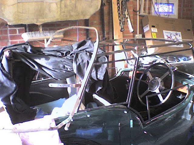

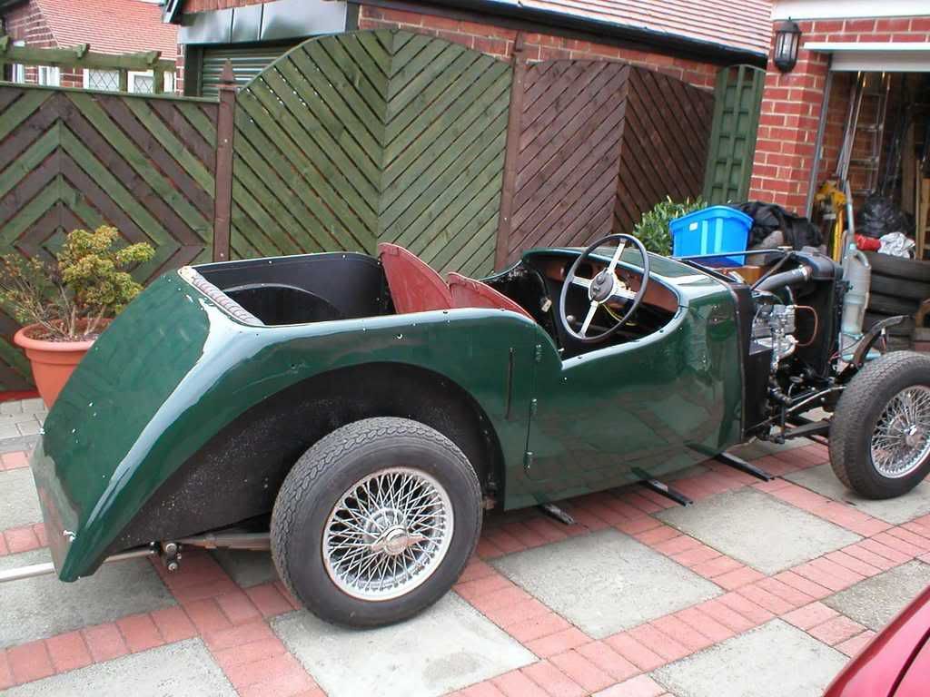

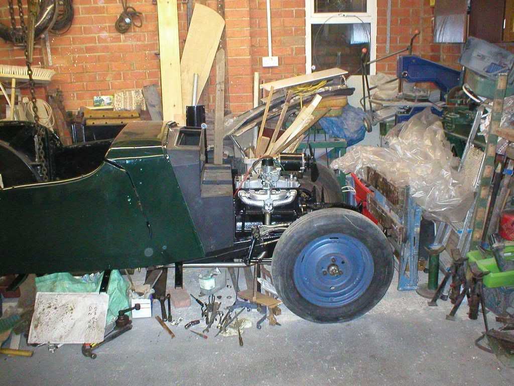

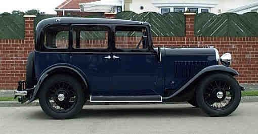

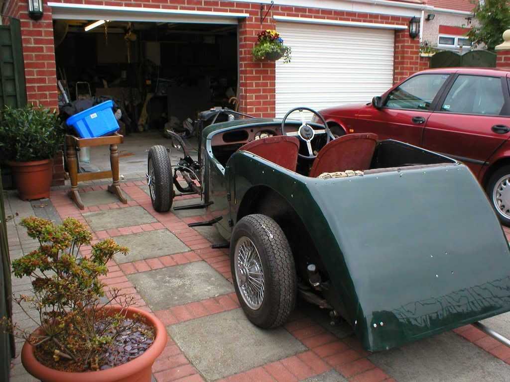

I have two cars.
The 1933 BSA 10 is on the road and the 1937 Talbot 10 is under restoration. It's getting there but the final 5% is obviously going to take 25% of the time!!
It's one of the Talbot 10 trafficators which is giving the problem and, as it's fixed from inside the car, we can't complete the trimming until we're 100% confident that it's working OK.
Thanks for your help.
Photos of cars
(RJ edit - fixed the photos. Use the code for Forums & Bulletins Wink )
