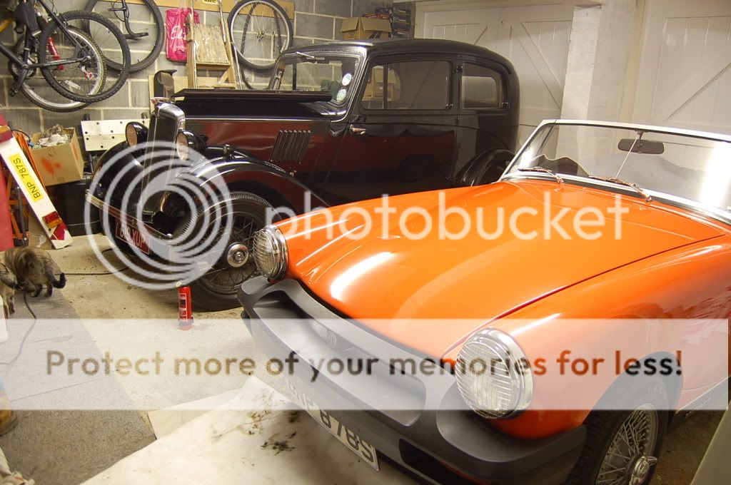

PostPosted: Tue Oct 07, 2008 7:46 am    Post subject: Reply with quote
Great looking car and garage! Not sure about the modern bikes on the wall, I think you need a few older ones? Laughing
