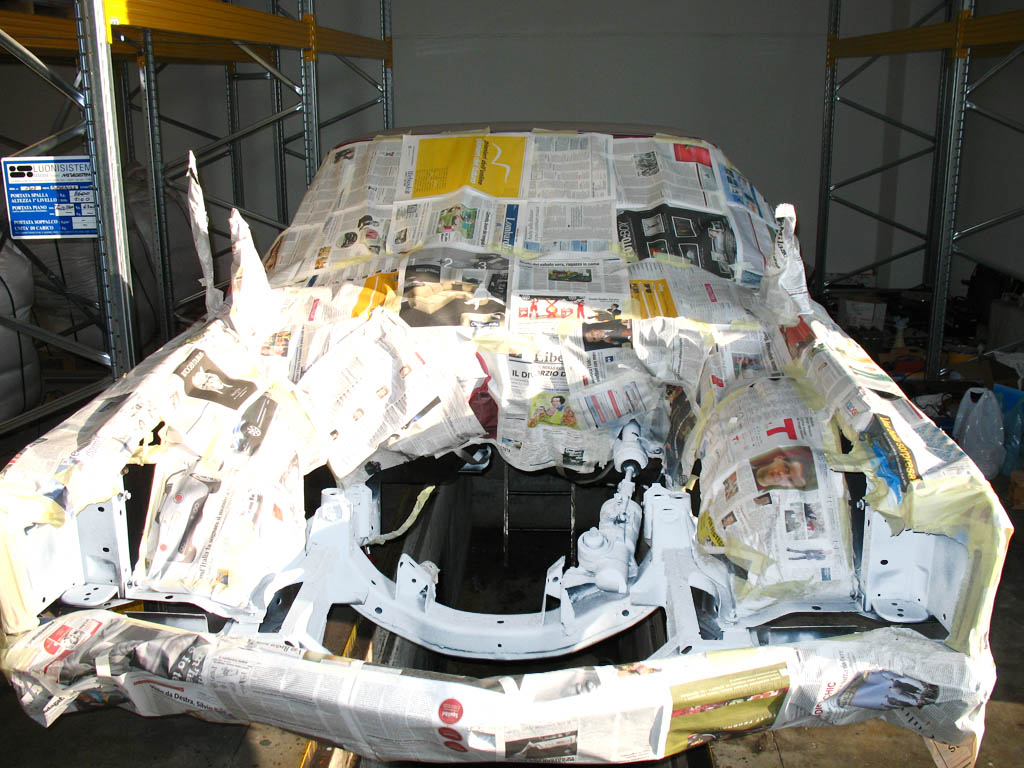

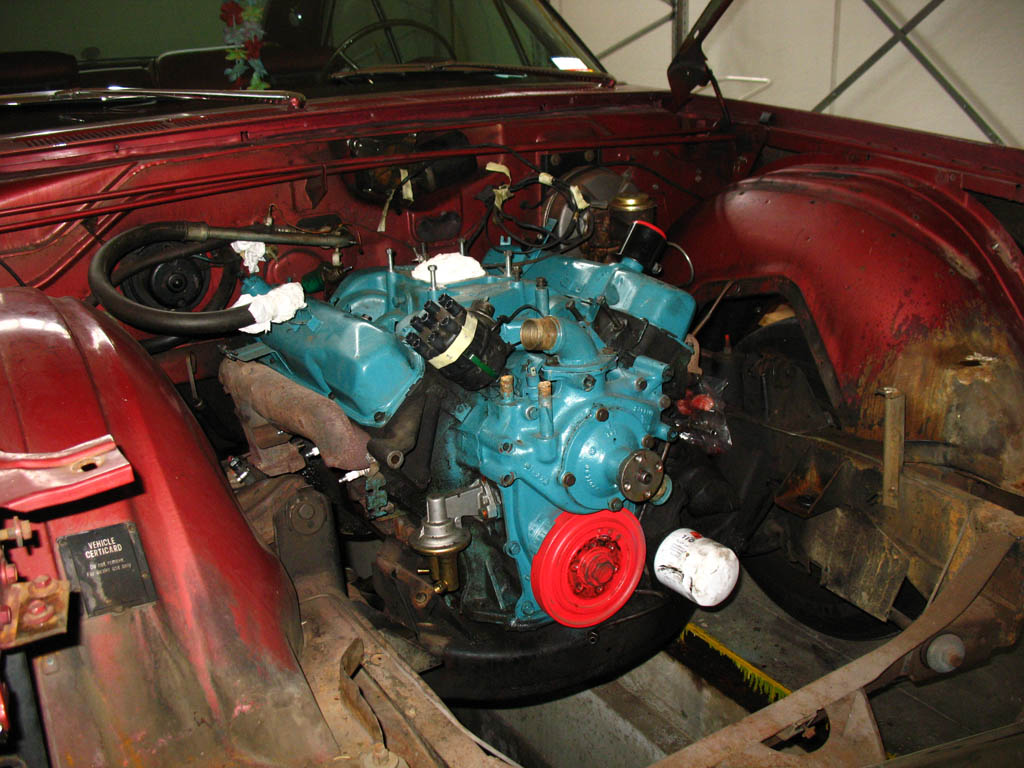

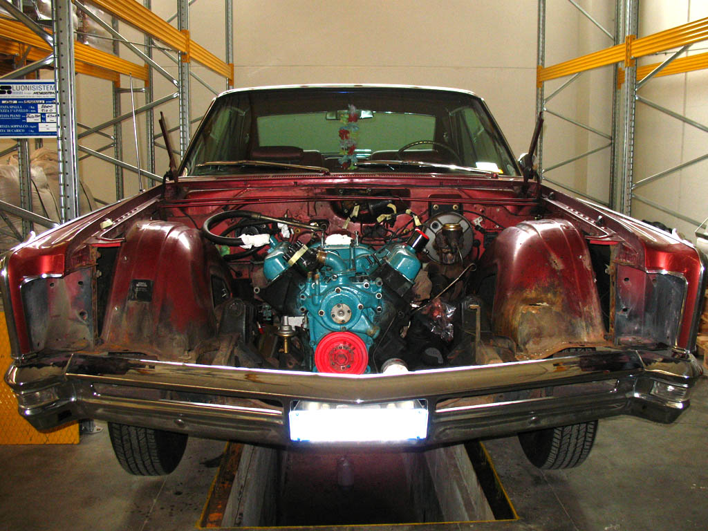

I will have a completely shiny new engine in my car, so I don't want an old engine bay with old paint and rust. So I decided to paint everywhere under the hood. Underhood included.
Some photos, that are easier for me than words!

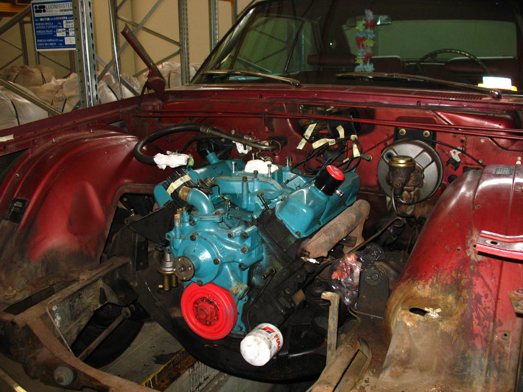

This is the engine bay before:

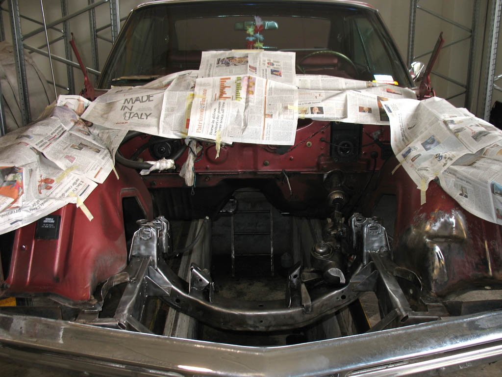

Then, after removing the engine, I brushed and cleaned the engine and suspension supports to bare metal:

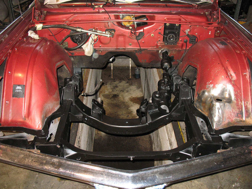

Then, the primer anti-rust paint:
And finally, the matt black paint:

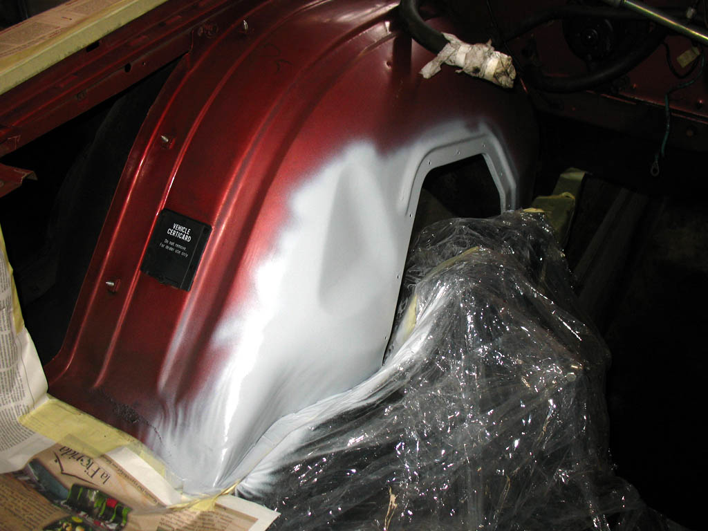

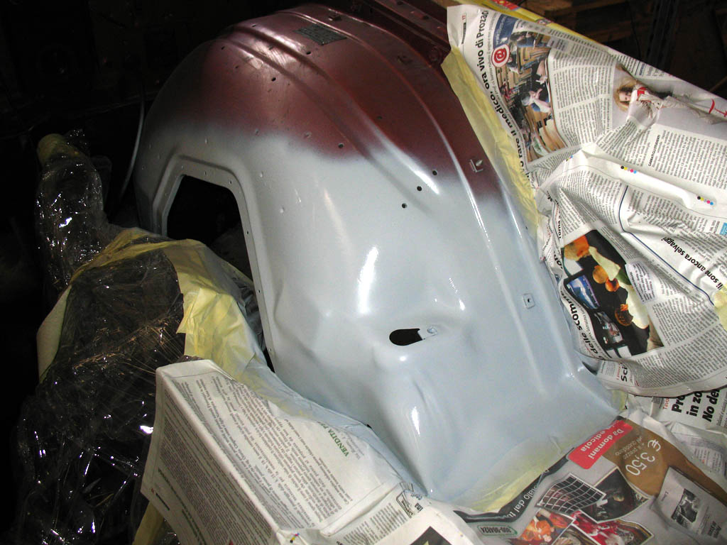

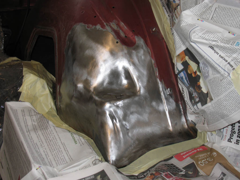

The bad zone of the fenders were cleaned to bare metal:
Then painted primer:

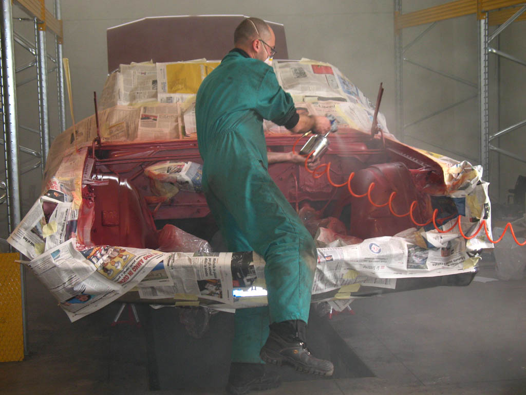

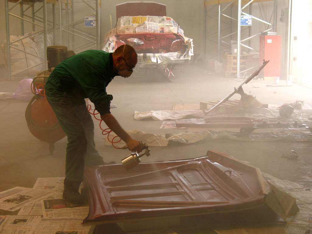

And then, after sandpapering everywhere, that's me painting! My wife catched me working...

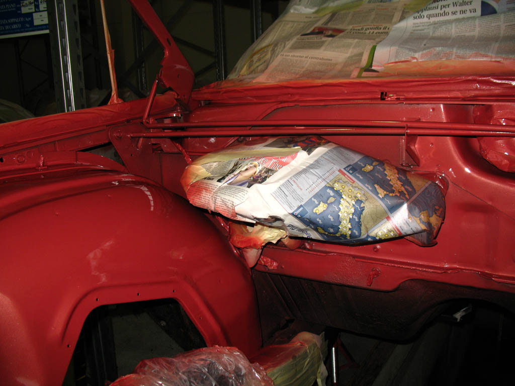

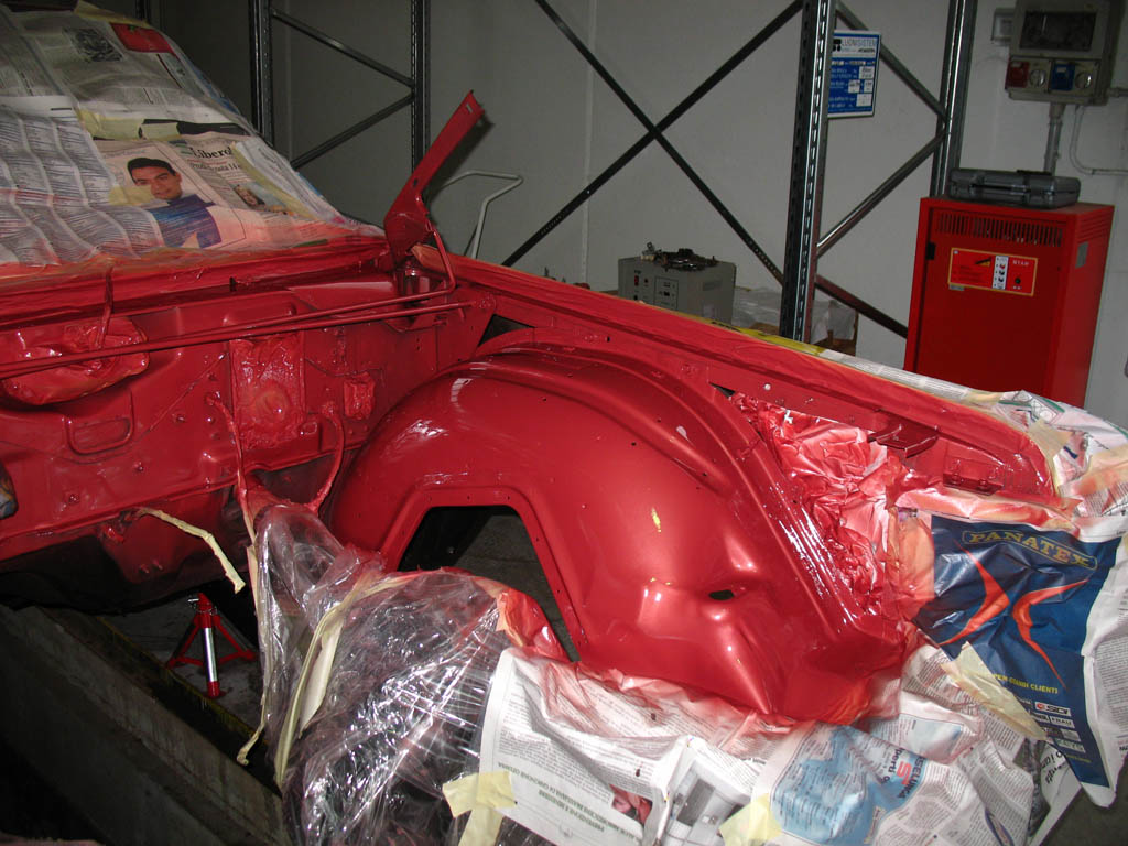

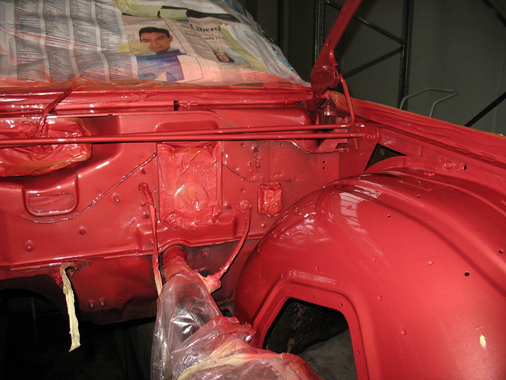

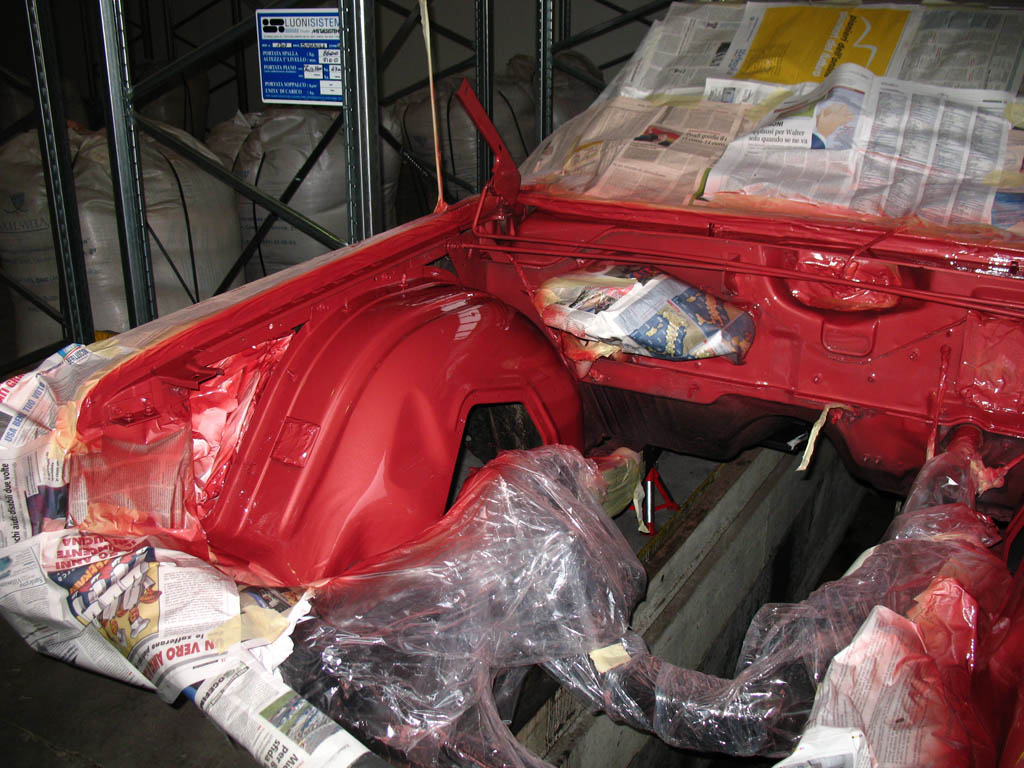

And this is the result of the job:
The red seems different in every photoshot, but is due to different light conditions.
I think is not bad, considering is the first time for me!
Ricky

What type of paint did you use? I see it's not 2-pack.
The paint was specifically made for the purpose, the first 2 coatings are od an opaque metallic red, and the second 2 coatings are of tranparent laquer with catalyst.

I'm just wondering why I couldn't have used that on my car then? Every forum that I ask tells me it has to be 2-pack or Waterbased clear over colour these days, but they tell me both are poisonous.
Did you just take a chance with the personal safety of was your mask enough?

O-N: The clear was two pack, as it used a hardener. But apparently the base didnt need one. So I'm wondering what that was! The mask he used was the type that Greeney suggested a while ago in another post. OK I think for short exposure, as long as it fits correctly, and has the correct filters. But dont take my word on this, I'm no safety expert

Was the mask the rubber type with the 2 filters on the front? not that one in the photo above, I wouldn't recommend that for 2pk
