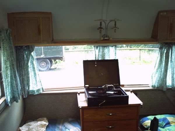

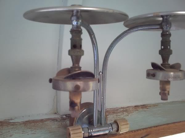

Thanks for that. If it was just me, thats probably what I'd do but the other half would certainly sleep easier if we had a seal of approval on it. We are however short of a coupe of bits for the kitchen light - the ceramic screw thingy that the mantle fits to and the fitting that the glass globe fits to. Yuo can see the bits on the pair of front lights but theres just a metal threaded end on the rear one.
If anyone could help with the missing bits we'd be very grateful.

am sure i have this gas fitting some where will have a look in my stores today. i do have some bijou gas mantles and some 1960s globes if your interested
cheers paul

That would be great if you've got the bits. Mantles would be handy too. We do have globes but they're not a matching set. No great problem, theres two which match for the front and an odd one for the rear.
Iain

i have the gas lamp fittings you want i can post them to you or if you are up my way pick them up ( J23a M1) gas mantles are £2.00 each and shades £6.oo the ceramic thingie and shade holder £3.00 plus post
if this is of any use to you email your deails to me and i can send them on

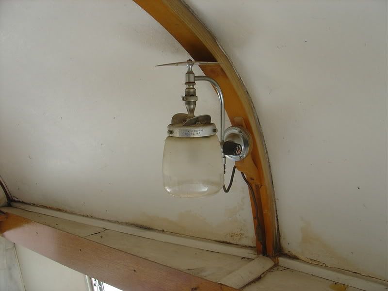

I am looking for 1 shade that looks like the picture below. I dont have a hope of finding one in Australia but if someone has one I am willing to pay all costs.
