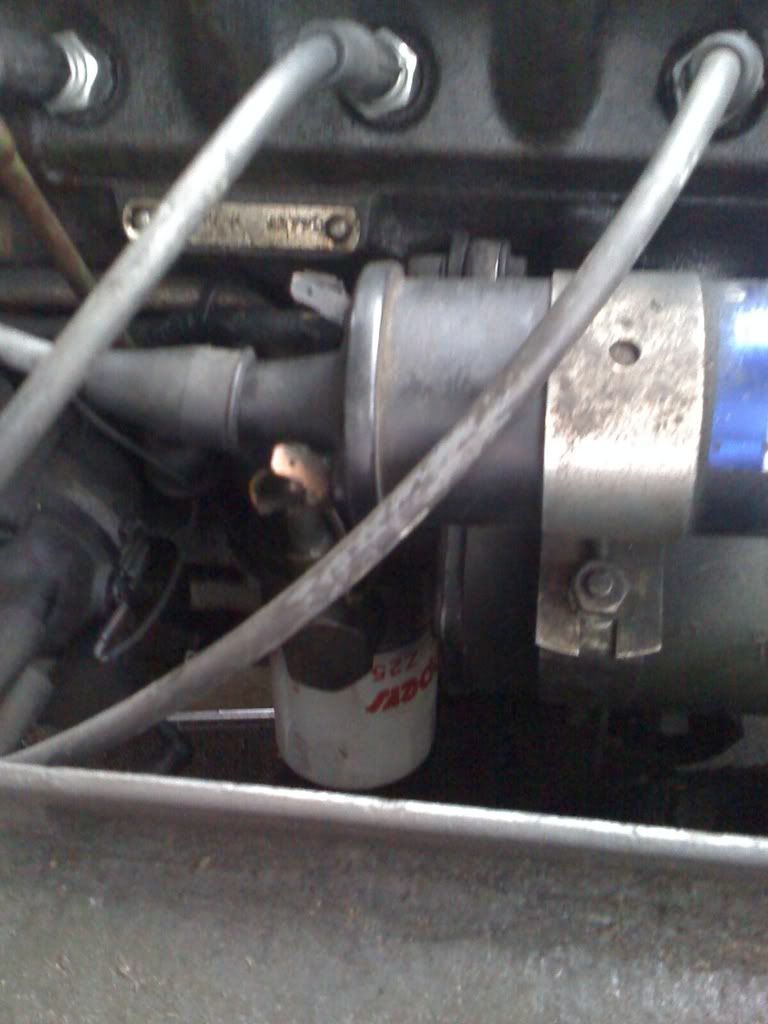

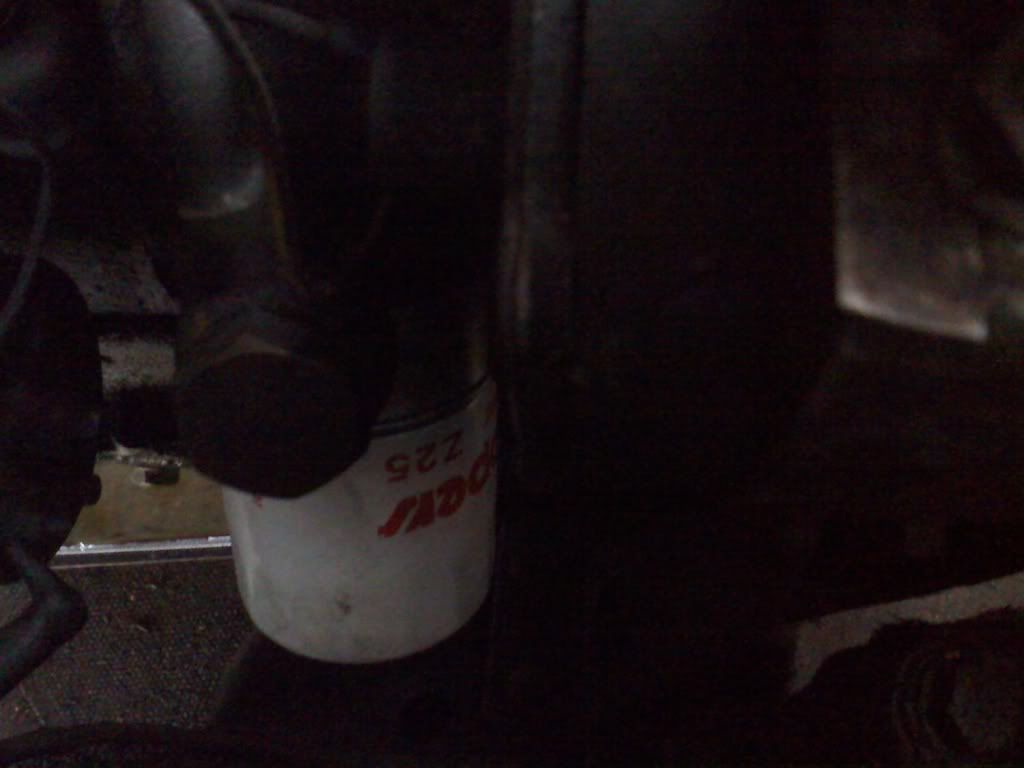

PostPosted: Wed Aug 20, 2008 9:36 am    Post subject: Reply with quote
Hi Rick
As you can see the screw on oil filter is a lot more accessible than the old one
Pete[img][/img][img][/img][img][/img]
Posts: 22837
PostPosted: Wed Aug 20, 2008 10:01 am    Post subject: Reply with quote
Interesting, I might look into getting one of those sometime
thanks for posting the pics
