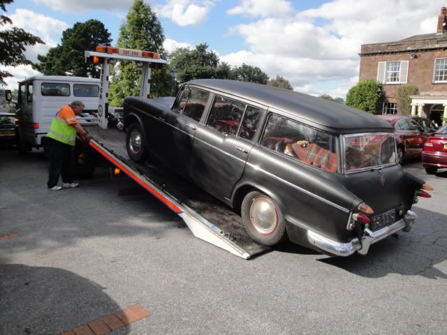

This my 1966 Hawk Estate. Its in average condition and has been mildly customised with custom made grill, 59 caddy taillights, earlier Hawk bumpers, the engine is good, the gearbox is bad - so bad in fact that i am in the process of rebuilding it. My plan is to keep it on the road whilst slowly restoring / Mildly customising it. Ive fitted a stainless exhaust, got hold of all four replacement lower wings / wheel arches and a recon box which I've had to dismantle so that i can fit to my car (the recon box was for non-overdrive ... mine has overdrive.. longer mainshaft!).
Important things to do: king pin bushes, inner / outer sills (O/S), new distributor (if anyone has a dissy for a hawk the would like to offer me i would be very happy).
General body work jobs to be done: all four wheel arches - dig out the filler replace arches and re-fill with lead, bottoms of doors to replace.
Custom things to do: fabricate new dash, door cards, rebuild grill (maybe fit an early imperial grill surround then re-do the teeth), re upholster, respray... lower? (not sure with all the speed bumps) fabricate hood ornament, re chrome, door mirrors, fabricate external sunvisor, fit high level spot light, or appleton style on A post, radius the bonnet corners.
but the 1st thing im going to do is get the gearbox in and start enjoying it... fingers crossed
being towed back from Devon after the gearbox died.
just before we realised that the gearboxes were different and a major task of dismantling was now ahead of me.
