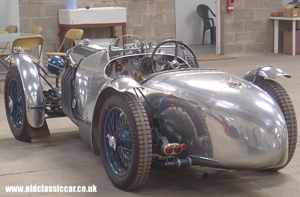

A chap who lives locally has a wonderful old Riley special that he bombs around in, I'll try and find a photo of it. I think it is similar to the TT Sprites of the 1930s.

This is the car I mentioned that lives not far from here (Cheshire). The car your father built looks superb!
That Riley pic looks like it was taken in a familar place, is it where I think it is, if so why?
yup CRR had an open day last year, and a few people brought along their old cars
