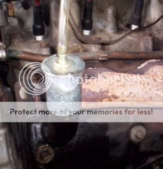

Browsing E-bay, I noticed this gadget, actually off a 6 cylinder LandRover.
Obviously the LR has PCV, so I bought it. The Air Inlet Silencer already had a blanked off bit of extra plumbing soldered into it, so I made up a curved copper tube and reducer. Next I swapped the original 'vent to atmosphere' tappet breather for the new one, connected it up and it seemed to work rather well.

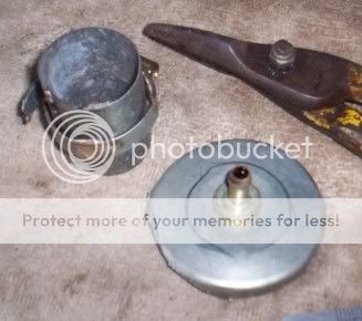

I hunted through junk but could not find any tubing or pipe that would be a neat fit over the oil filler tube. I ended up cutting a strip of galvanised steel, then curving around a former and holding it temporarily with a hose clamp. After checking the fit on the oil filler tube, and some adjustments, I soldered it to make a cylinder.
Next requirement was a cap for the cylinder, and then a nipple to take a flexible tube. In my hunting through junk, I came across an old discarded fuel filter from my EFi Rover SD1. A few minutes with the tin snips and I had one end off. The cap and a nipple in one go!

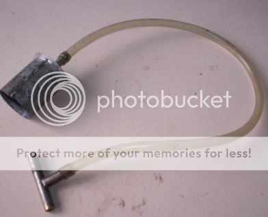

All I had to do was trim it to size, then solder it to the cylinder. Now I had to make up a T junction of brass tube for the air silencer end. Here is the assembly.
And here it is replacing the original oil filler cap.
