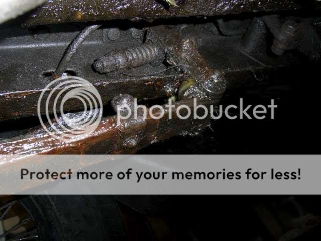

Viz the spring movement, that would make sense, I did not know one end was not supposed to move! I assume that the static end is the front as the rear end of the spring has this spring arrangement - photo attached

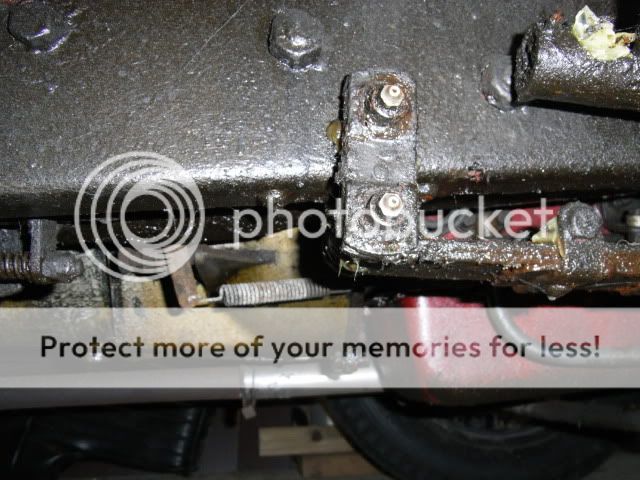

I guess I need to take the front shackle apart. although I do not really see how it can avoid movement, as it is similar in design to the rear with the exception of the spring and extension. It consists of two plates and two bolts, so I would have thought that it would move quite easily? see this picture (although this is the rear shackle the front is the same)

Hi Tim,
I may be wrong but I think that your rear spring pivot is intended to be fixed and the thing with the little spring is an adjustment for setting the axle straight. So maybe you should check for play at that end.

Actually I am wrong it's not an adjustment it's what's called a kick-shackle.
See: http://www.monaro.org/advanced_steering_and_wheel_alig.htm
I still think it should be largely fixed and there is something wrong if it allows axle movement in response to steering. The front should move when you bounce up and down on the car and the rear should stay still.

It is possible that turning the steering when the car is at rest is an unfair test. The forces needed are much greater than when running. I assume your drag link runs fore and aft and will thus push and pull on the axle.
Having said that, the forces generated by braking will be even greater still. Given that the kick-shackle is only on the offside I would have thought that the car would always pull to the right under heavy braking. Does this happen in practice?
Whilst you certainly don't want shimmy I think pulling of the brakes and
unpredictable steering are equally bad news. I'd be tempted to try and lock up the kick-shackle as much as possible. I suspect the nut on the
left of your photo will act to compress the little coil spring and thus limit the free movement of the shackle.

yes, actually what you say rings true, I thought the car would fail it's MOT because the brakes pulled to the right. The MOT test showed the retardation to be pretty equal.............
On closer inspection the spring arrangement on the rear offside shackle is so tightly wound that the "spring is practically solid" I wonder if the PO has tried to take up the movement in the shackle by over tightening it.
I think there is no option but for me to take apart the drag link, and both shackles to see what gives (maybe literally) I assume this is fairly straightforward with no hidden keys or techniques needed.
