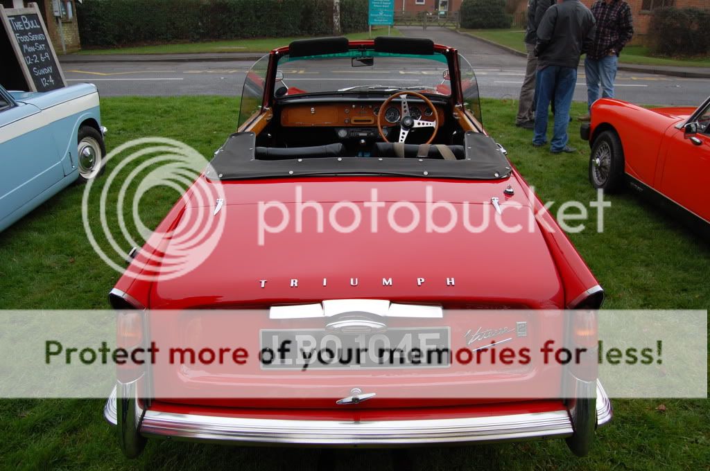

Hi Poppet, glad you got it sorted. I have always liked the Vitesse. Here is a rather nice one at the Newmarket Classic Car Club.
Umm, nice. Thats my Midget next to it.
