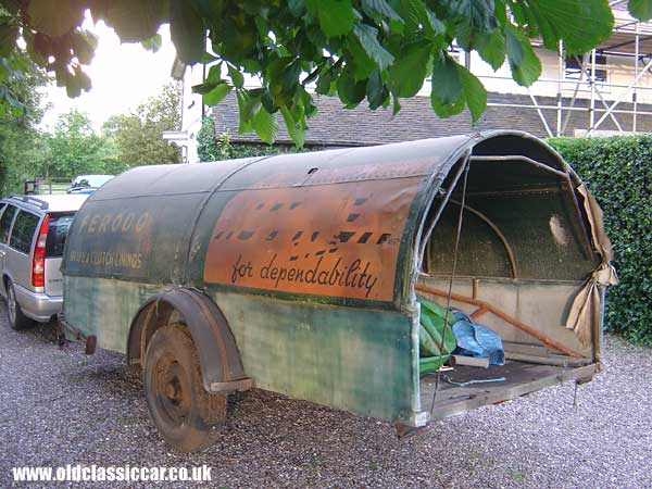

The wings on the Dodge's trailer are rubber, not unlike those found on Post Office Morris vans in the 50s. Has anyone got tips on how best to preserve them?? they are fitted to an alloy bracket inside, and a steel one running over the top surface, but the edges are still vulnerable. Are there any treatments that can preserve the rubber?
ta, Rick

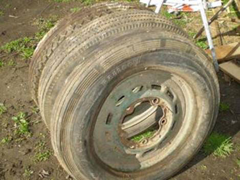

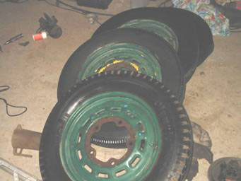

"I just bought some old rims and tyres for my thames pickup they are pre 1948 rims, they are 18" and were available for commercial vehicles only, quite hard to find have only seen them advertised a couple of times over the last 3 years and only one or two rims not 4. I bought these for 155.00 nz, freight was 120.00 to get them here but still think that's a good price, the tyres are in good order a couple are retreads very old.
The rims and tyres were all dusty and dirty and covered in old paint so I
cleaned them up.
Here's a couple of pics of before and after they have good tread and no major cracking so are useable I just washed them with some soap powder and used a wire brush to remove the over spray and a lot of elbow grease I also treated them with glycerine as I have some available it restores the condition of the rubber. I have used spray silicon crc and had good results or have heard others use armoural they
are not painted its just the natural rubber made me think that by treating
the old tyres will make them last longer by reducing cracking and perishing as well as improve their appearance. Dirt oil and solvents are a threat to old tyres.
One of them still had the original firestone label they are very old, a couple were made in south Africa amazing what a clean up will do am pleased I bought them now. Brent"
These tyres are not in 'good order'! They are potential deathtraps and should be scrapped immediately.
You're not actually intending to use them on a road vehicle are you?
I thought we'd got this message through to everyone through club magazines, forums, etc.

PostPosted: Tue Oct 21, 2008 11:19 pm    Post subject: Reply with quote
Tyres still degrade and harden and develop flats - anything over 10 years is very suspect and even newer in hot climates.
People have died in classics and modern cars driving on old rubber - if you do not mind killing yoursrlf the others that will be involved may not share your views
