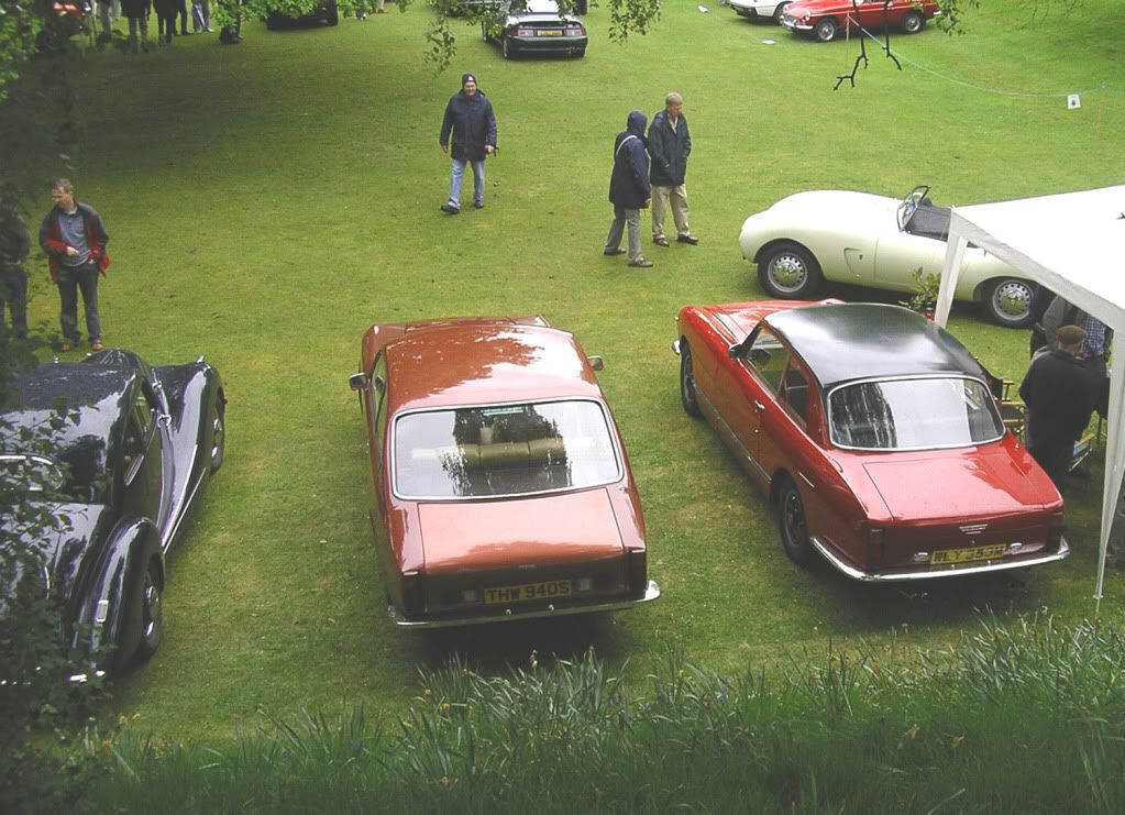

Posted: Sun Mar 15, 2009 9:40 pm Post subject: |
I have a friend with a Bristol 411, it is the one next to the Gazebo in this picture.
It is actually a painted roof (allegedly Concord nose paint) yet even close up it has a look of a vinyl roof, except for not having the extra pieces towards the edges which you often see.
It even has a slight "orange peel" finish which vinyls seem to have.
