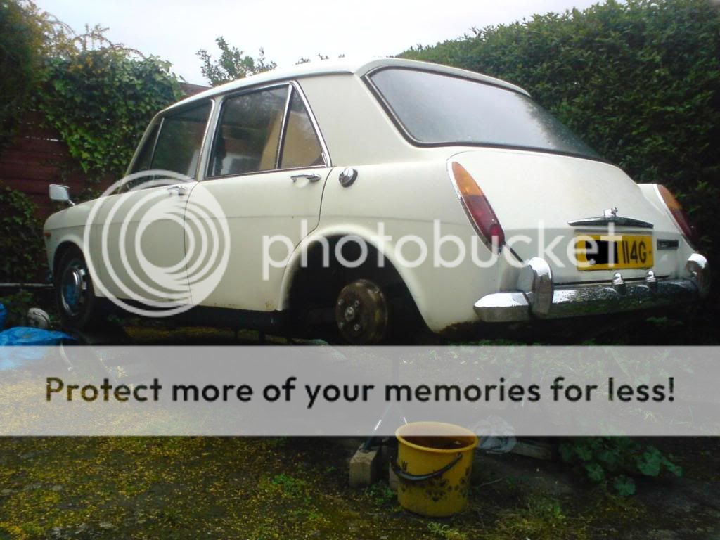

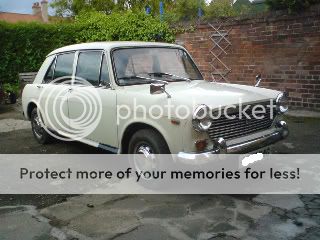

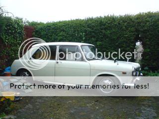

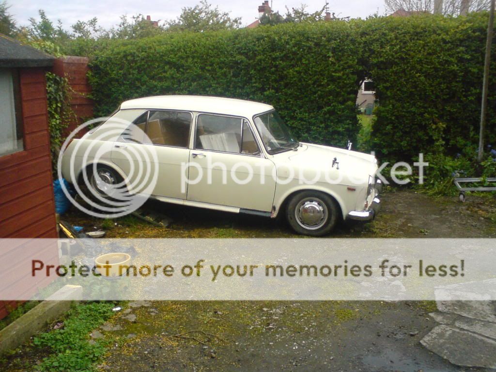

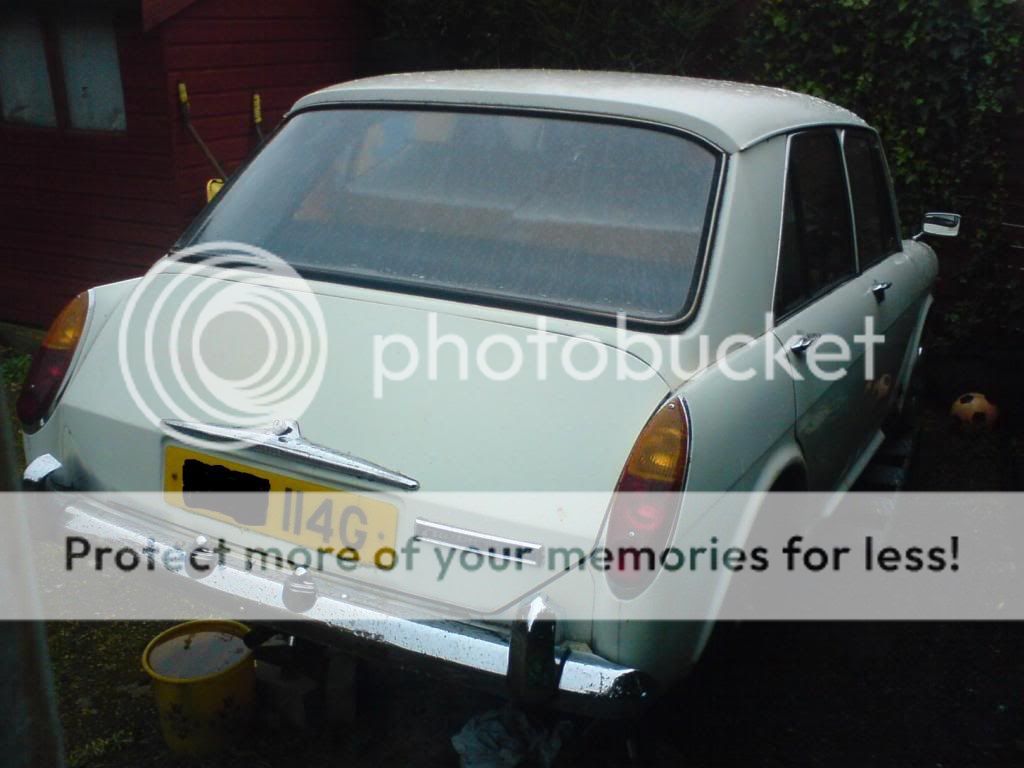

Just a few pics of my 1969 Austin 1100 - some of which I'm sure she really doesn't want you to see. These pics were taken with a very basic camera on a phone so I apogise for the quality of some.

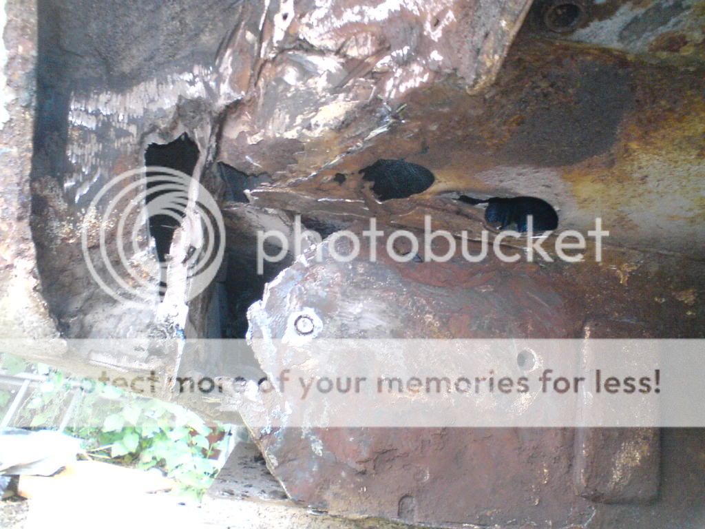

Bought this car in August 2006 then left it untill I started work on rear subframe June 2007. Started hacking away at the cills (what a horror story) last autumn then the weather put me off till spring. Just finished welding the cills and floor last week.
now I need to bleed brakes and take it to the garage for suspension pump up. Had to replace o/s suspension pipe so I hope it holds when they pump it Embarassed
In an ideal world this car will be on the road SOMETIME in the summer as it is 40 this year.
I am not a perfectionist i just want a workaday 1100 to knock about in so don't expect lots of shiney polished bits....it's just not me. Wink

Tester found more rot today Evil or Very Mad and some sundry bits and bobs...
So it's back out with the mig next week, I can't be a##ed this weekend. Crying or Very sad
