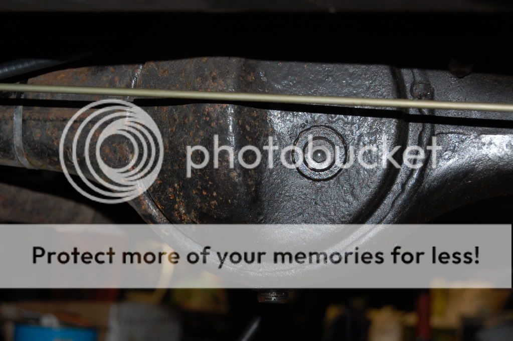

does anyone know the size of square wrench socked that is used to remove the rear differential drain/top-up plug? i ordered one from mgocspares but it was the wrong one.
thanks
oh itsfor a 76 midget 1500

thanks for the replys. it looks like the drain socket i was sent would fit the replacement plug as shown above, the problem is that i have the old square type.
i managed to get the gear box oil changed (BIG FAFF.. NEVER AGAIN) and the engine oil. the actual drain plug on the diff is fine and turns, but its the refill plug that wont budge (after loads of free and release, and a big hammer). will need to think of a new strategy.....
