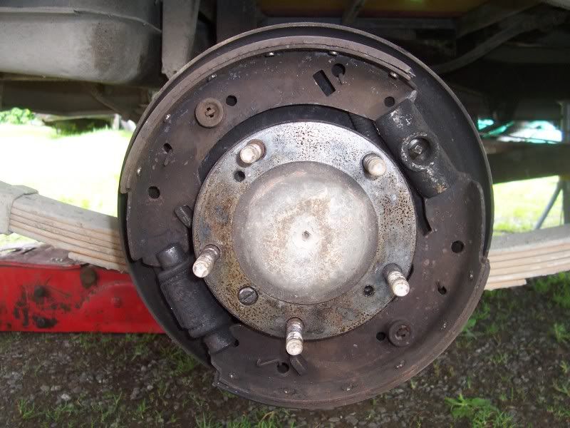

Can anybody identify this axle?
michael1703
Joined: 22 Jul 2009
Posts: 349
Location: suffolk
PostPosted: Thu Jul 23, 2009 8:50 am    Post subject: Can anybody identify this axle? Reply with quote
This axle was (badly) fitted to a bedford ca that has just been imported from turkey
was thinking early transit,cf,sherpa or p100
any ideas?

Looks sloghtly Marina-esque to me, but there are I haven't touched one for a long time. Half shafts are similar and it has Girling Brakes.

well paul, i thought you had the answer, i did think it was morris when you mentioned it, but no
tried the 7wt van and ital and rover variants but its not those
the handbrake linkage reminds me of an mgb arrangement, the wheel cylinder is held on with a circlip and located with a rollpin like the mgb but its heavier duty and the adjuster is huge
its bugging me, i recognise it from somewhere
the brake shoe is a lockheed which has the part number 3342-641
the wheel cylinder is stamped
3221-827
the adjuster has no (visible) part number

Could it be from an Austin/Morris J2 van?

the wheel cylinder is 1968 ford transit
the brake shoes though.... err.. is anyones guess
luckily they are useable

Yes, I'm pretty sure RotaryBri has it with the Austin/Morris J2 van although the spring shackle arrangement looks different. Maybe modified to work with the Bedford springs.
