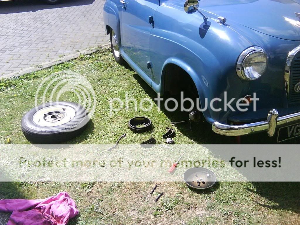

I hadn't driven the car for a while, and I noticed the brakes were pulling badly two days before we were about to leave. I took of a wheel to reveal the brake shoes covered in fluid. I replaced a wheel cylinder and the front brake shoes and took it for a spin. It was still pulling, and after two days freeing off wheel cylinders, swapping shoes, drums, adjusting and bleeding brakes, and fitting new brake springs, I finally had half decent brakes!

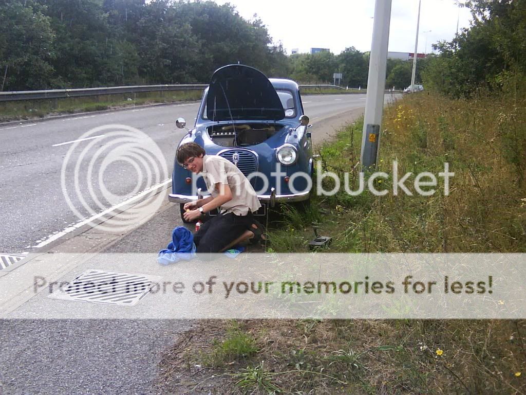

We then got as far as Brentwood before it started trying to cut out. I pulled up in a layby then realised I hadn't nipped up the wheel nuts after working on the brakes the previous day. So of course I managed to shear off a wheel stud. I didn't want to drive round the M25 with a poor running engine and three wheel studs, so I called my breakdown assistance:
It took us six hours from breaking down to reaching Camber. When we got there I gave it a test drive and it seemed fine.
