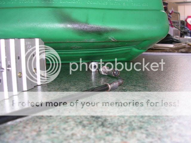

I have been planning to sort the wiring out in the boot for some time but now it will have to be done.
I was driving home and I noticed the radio had gone quiet, nothing unusual around Cavendish as there is poor reception. I looked at the radio and smoke billowed out of it. Fortunately I had the top down and I managed to flip the front of the stereo off but it continued to smoke so I turned the ignition off. I coasted into a conveniently placed lay by and I yanked the radio live feed from the battery - job done and I am 5 miles from home.

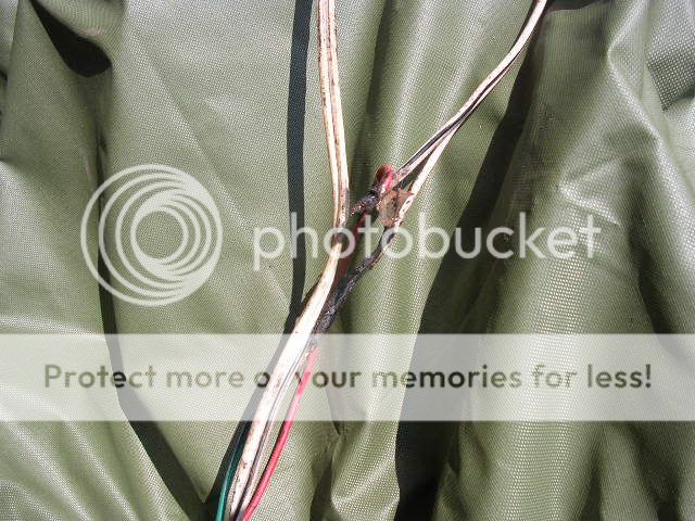

When I checked the wiring in the boot I found the live feed to the electric aerial had rubbed on the spare throttle cable that was under the plastic petrol can that is FULL. The cable must have glowed red hot and the thread on the adjuster had melted into the plastic. How lucky is that - I think God loves me.

I checked the fuse in the stereo and it is OK. Very strange as the feed for the aerial comes through the unit. If anyone has an electric aerial put a fuse in the feed.
