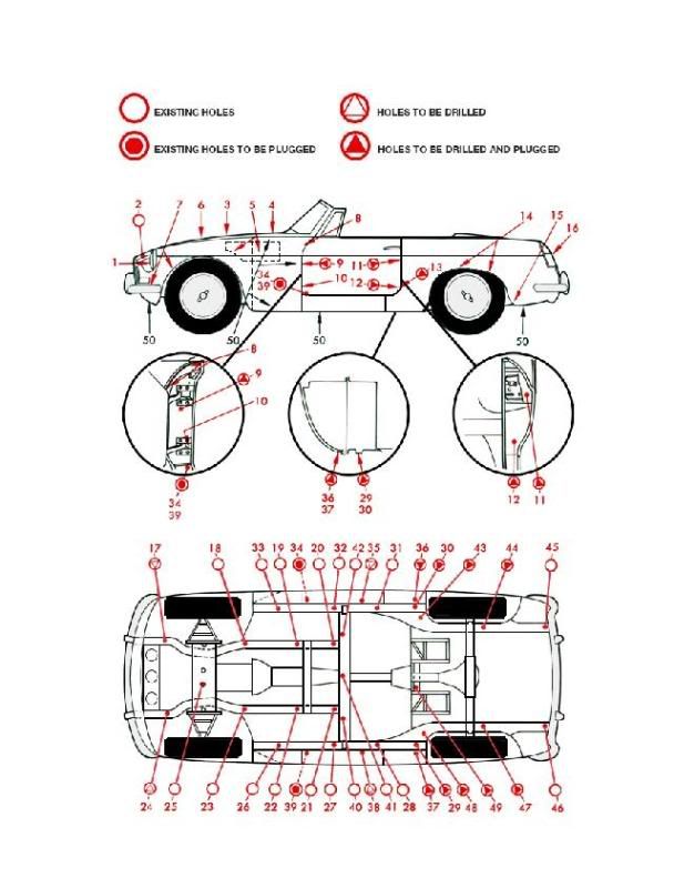

What ever product you choose, this is where / how Ziebart used to recomend applying it to an a MGB. AS you can see doing it properly is more than just a quick blast !!

Thanks UKDave,
Any chance you could e-mail me a full sized version of this diagram?
