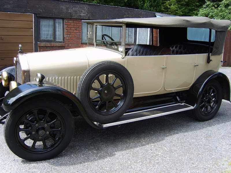

Hi, I Have a 1927 Humber 14/40 of 2050cc. It should have a cox atmos carburettor but it’s missing. I have a good bronze 1920s SU type carb which I intend to put on to this car but wonder about the needle/Jet size, the carb’s inlet is 1” or 1and 1/8” any Ideas would be very welcome. Here is a link to have a look at the car.

Hope you don't mind, I'll bring up one of the pics of your car:
Funnily enough you've just helped me i.d. the make of a car that I've been looking at today in an old photo.
Re the carb, do Burlen have any records or data going back that far??
rgds, Rick
