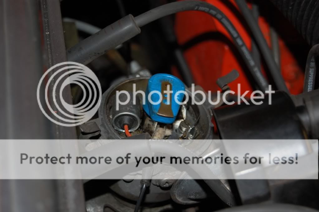

I had a little play with the Midget engine so I thought I would post this photo
It clearly shows the brass contact in the rotor arm has NO stud/rivet holding it on but it is moulded into the arm, this gives good insulation. If the material that the arm is made of is the problem then one would expect it to fail imediately. I cleaned the inside of my dizzy not too long ago and yet there is some crud back in it already. I still think that the stud/rivet may well be the problem as there is no insulator between it ( electricly hot ) and earth ( 0v ) where as my rotor has a big lump of plastic between them. A small amount of contamination would allow the stud/rivet to track to earth. The old black rotors did not seem to be a problem but then they did not have stud/rivets in them.
