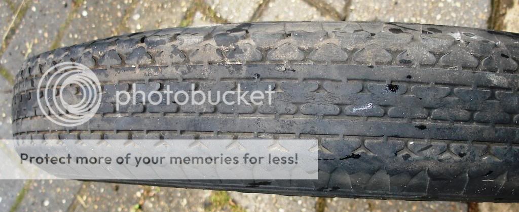

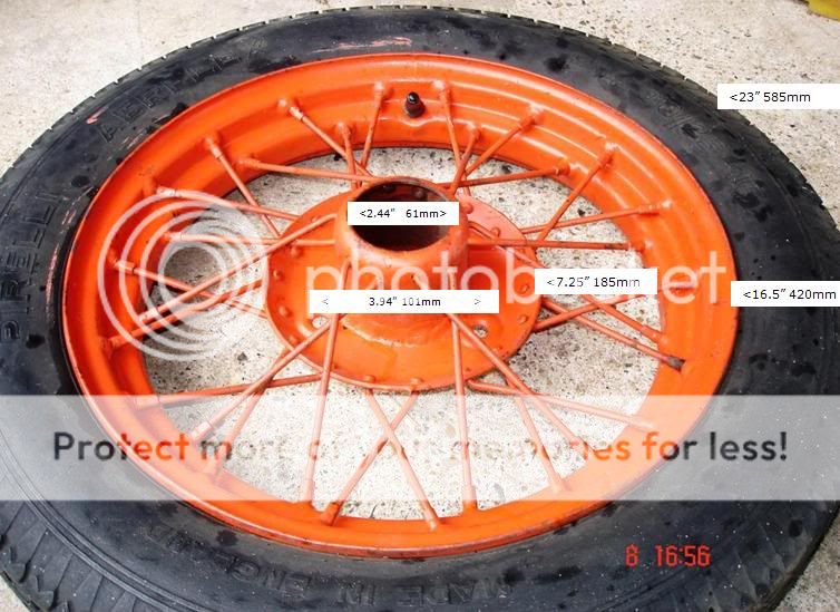

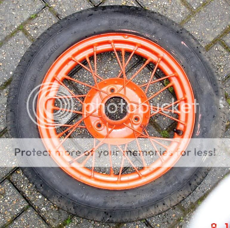

I have been trying to identify the wheel shown in attached photo
Nothing sporty or special - probably run of the mill family motor marque
See the dimensions on photo
Diameter centre hub hole facing brake drum circa 3 inches 76 mm
3 stud holes
30 wire spokes
Tread width circa 2 7/8 inches 73 mm
Tyre - Pirelli Aerflex 4.00/25-15
Most internet sites seem to concentrate on high end racing wire spokes
Thanks to anyone out there who can put me on the track

PostPosted: Wed May 26, 2010 5:50 pm    Post subject: Reply with quote
In view of your username I assume it is not a Seven wheel although looks just like a set my brother has which were built up for a special. Anyway there is no provision for the locating stubs on the hub.
How about Morris Minor/MG M which are 3 stud 19" normally but I think this has a non standard rim??

You may be right about your Austin 7 suggestion - memory of detail is a bit faded since rebuilding one over 40 years ago !
I acquired this wheel from someone who had Bugatti, TVR and SS Jag - so A7 did not come immediately to mind - since I always thought they were 19" and had an elongated hole for hub studs and threaded studs.
I now find that many sizes were used - the three stud holes does suggest A7 - A7's had open and closed hubs I understand. See photo here of A7 wheel - mine has 9 pairs of spokes on the inside whereas the A7 photo has 12 pairs inside and has a hub which covers the brake drum whereas mine would sit flush to the outside of brake drum cover.
I've since had a look at photos of Morris and MG 1920's 1930's and now am moving away from Austin towards MG - but it is difficult to get a clear enough pic or resolution on this photo research - maybe MG M ? I suppose Standard, Riley and Wolsley are also possibles
I am hoping that someone on the Forum can confirm beyond doubt from better knowledge and experience than I have
Grateful for your helpful input
Colin

Many thanks for your help Roger - your wheels look very similar but the stud hole diameter and centre to centre is different
Good suggestion Steve but the source for this wheel was unlikely to have been involved in bikes - may still have been used for side cars
So I must still keep trying to come up with a final answer for this wheel

PostPosted: Sun May 30, 2010 9:17 am    Post subject: Reply with quote
I sold one of these a year or so ago. It was with a pile of Austin Seven Special parts. It has less spokes than the normal seven wheel and the hub looks the same as the old London Wheel Company (I think that was the name) products. Possibly a goody available for the 1950s special builders.
If I could have sourced another four I wouldn't have ebayed mine.
