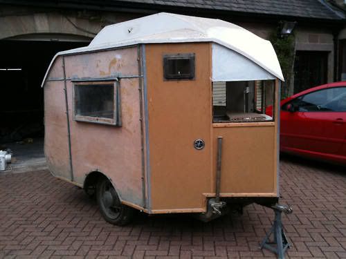

1934 vintage caravan, County by Car Trailers Ltd (on ebay)

I've never seen one like that before.
It would be great to kit it out for one person with a fitted cooker, oven, toilet, sink and a fridge.

Now mine any help advice on what colour to paint What tyres i could fit.They are 125x15 will be towed with my fire truck camper i hope.

the original color, is county cream what's wrong with that ? Smile
when i saw this van for sale ,12 years ago it was dark blue and the roof was covered in felt ,, Laughing Laughing , i hope you are going to restore her back to original its a unique little van, the only other car trailers survivor i know of is the camping trailer this is like a tent in a trailer, nothing like a caravan ,
just a friendly word of advice if you intended to tow with your fire truck you may need to make a sprung mount for the tow ball , the suspension on lorries and trucks is allot stiffer then the caravan,s this can shake a lightweight van's apart , it really depends on how stiff the suspension is on the back of your waggon OVM

Why do you think that what you've got wasn't original Pete?
Your 'van is pretty innovative.
Why should your hitch be bog standard?
Quite a lot of hitches in that period were just flat bits of metal with a hole near the end.
The female on the motor may or may not have been hinged vertically.
I suspect that the idea was that that the metal tongue on the trailer flexed.
Howzabout making a hitch that will work with what you've got?
