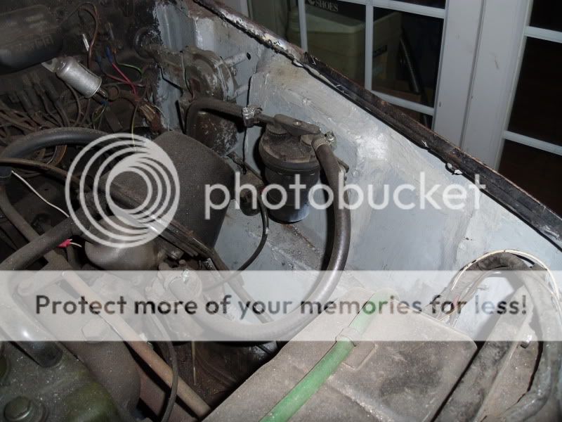

And the fuel pump temporarily fitted, so I can move the car in and out of the garage.

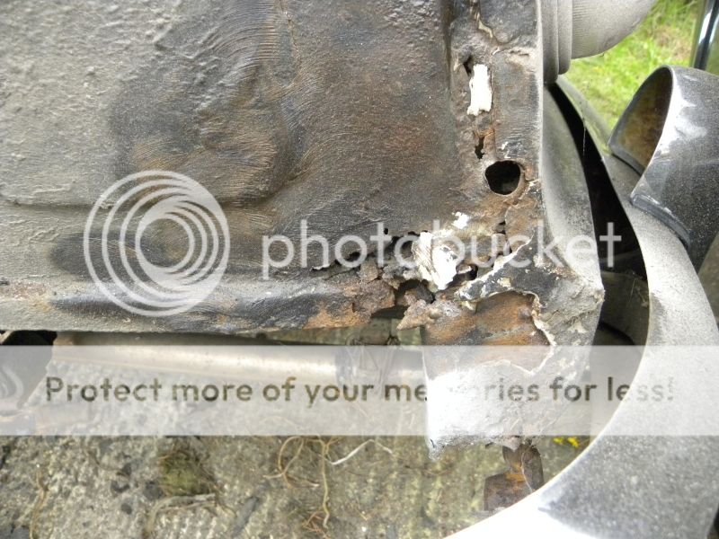

Well I hacked out the plates and rust, this is what I was left with:
See that crusty 90 degree section in the middle of the hole in the first picture? That's what's left of the inner sill! Everything here is toast.
So I made the first of many panel purchases from Earlpart - new N/S floorpan, and both original spec outriggers for that side.
I also bought a Car roller on Ebay back in November, which will make the underside repairs so much easier. By coincidence, on arriving at the seller's house in Surrey, it turned out he was a fellow Cambridge-Oxford Club member, and he had just finished restoring an A55/A60 1/2 ton van based Suntor caravanette to concours standards. He cut his inner wings from a donor car...

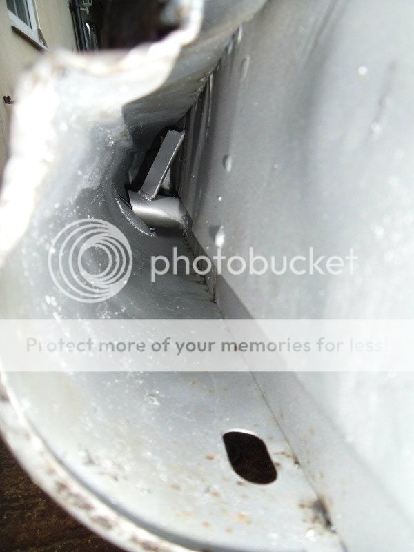

View inside the sill:

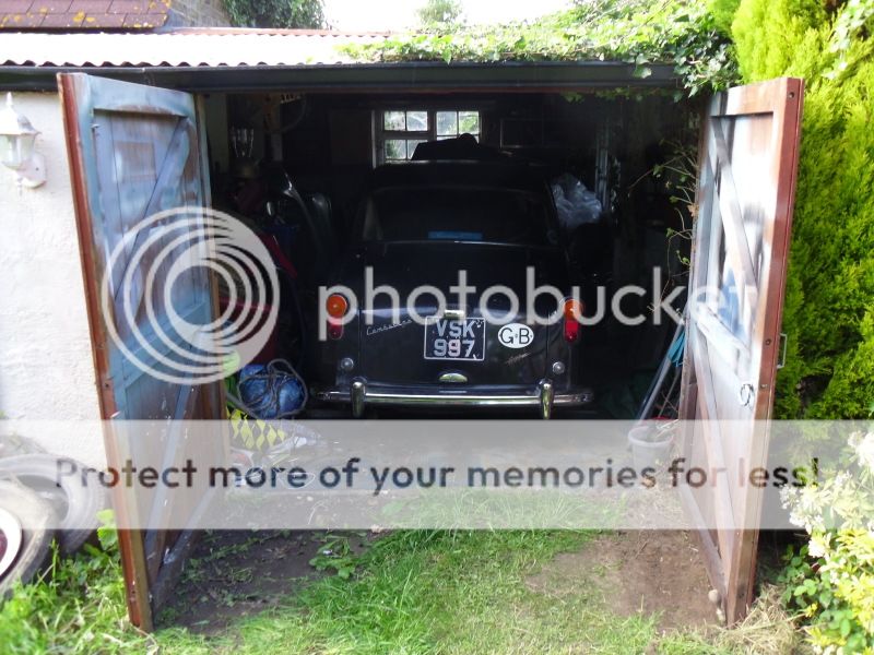

At this point I decided to remove the car from the car roller and drive it into the garage which I recently cleared out for it to go in for the next month or so (to do the rear inner wing and rear valance). Surprisingly, after putting a battery on the engine started fairly easily, not bad for about 6 months on its side. I had to put some fluid in the clutch cylinder before I could drive it though!
