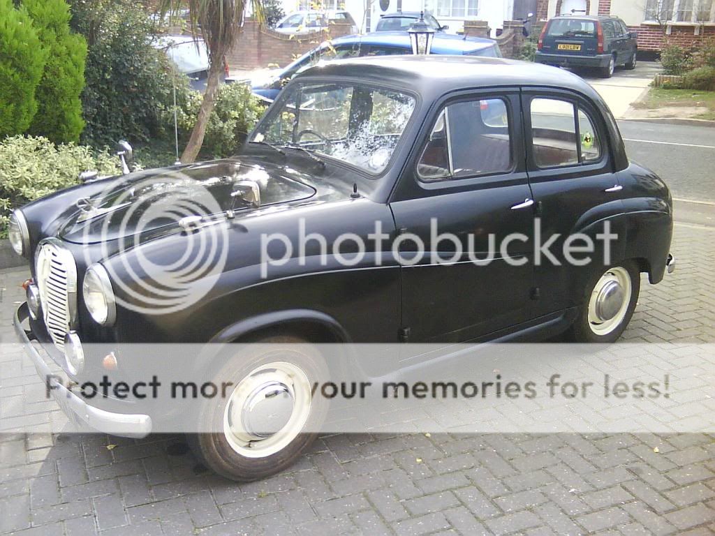

Bought this on ebay on Thursday, drove back from Tring on the Herts/Bucks borders on Saturday, and I've done about 300 miles in it so far!

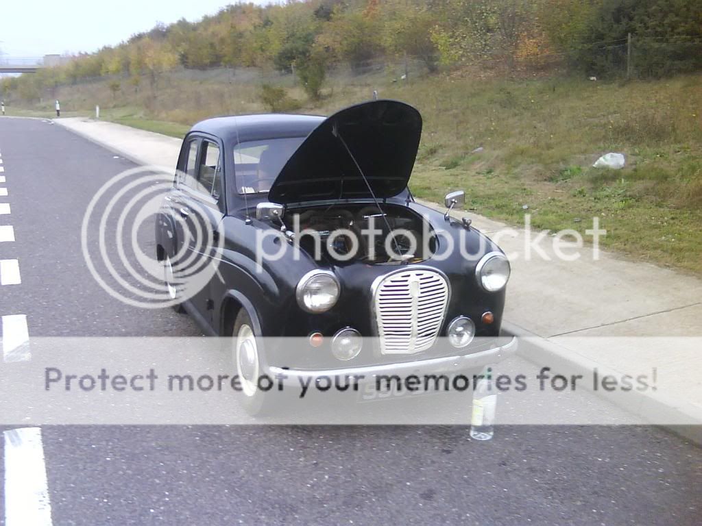

The car was laid up in a barn in 1985 and was Mot'd in May this year for the first time in over 20 years. The car had only done 60 miles in the last 24 years, so it was a pretty nervewracking drive home! I stopped for a rest (the car was running fine) when I noticed steam pouring out of the grill. A leaky heater hose had caused it to overheat (since replaced). As soon as we got home we filled the steering box, which was empty, greased the suspension and steering which hadn't been greased for years, and adjusted the clutch. Unfortunately there is quite a lot of blue smoke on acceleration, so next week we're taking the cylinder head off and giving it a decoke, with new valve stem oil seals. The gearbox is really crunchy on third and fourth gears, indicating synchromesh wear, but it just adds to the character! (and is avoidable if you are careful enough).
Interestingly the car has only had 4 previous owners. The last owner only bought it in May. The previous owners were a husband and wife, she bought it in 1982, and transferred it to her husband's name 6 months later. Which means the first owner had it from 1957 - 1982. The car seems to have spent most of its life in the Welling, Kent area.
Slight problem on the way home...

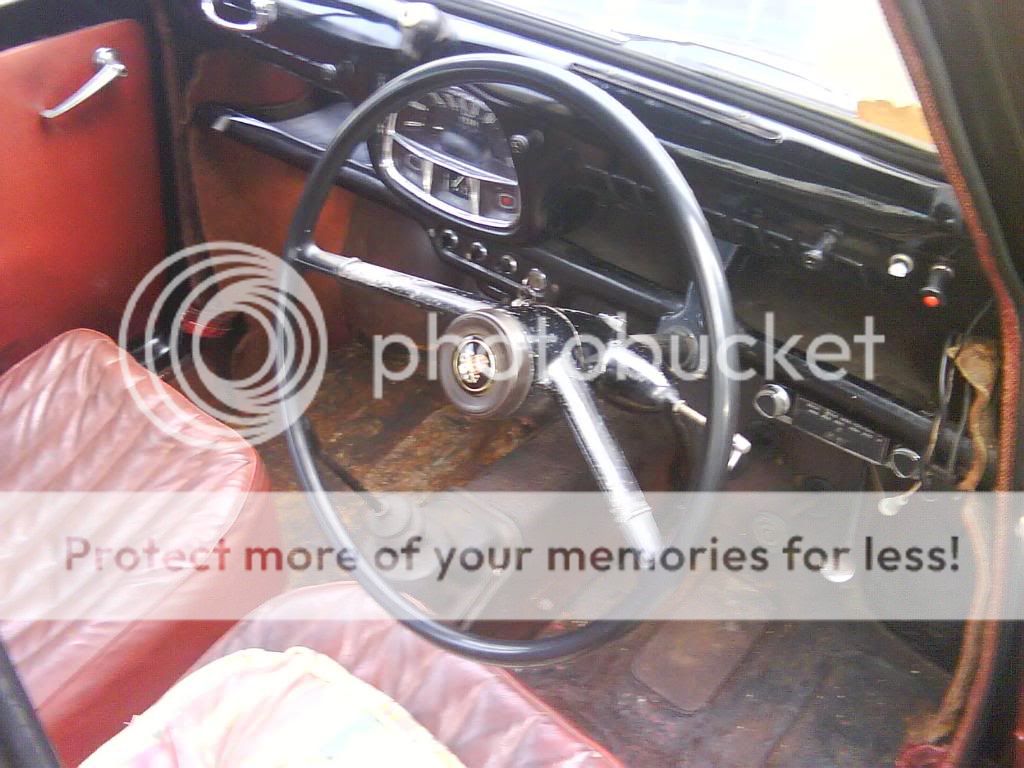

The original rubber mats and carpets are still present. The mats have been removed in this picture for repair.

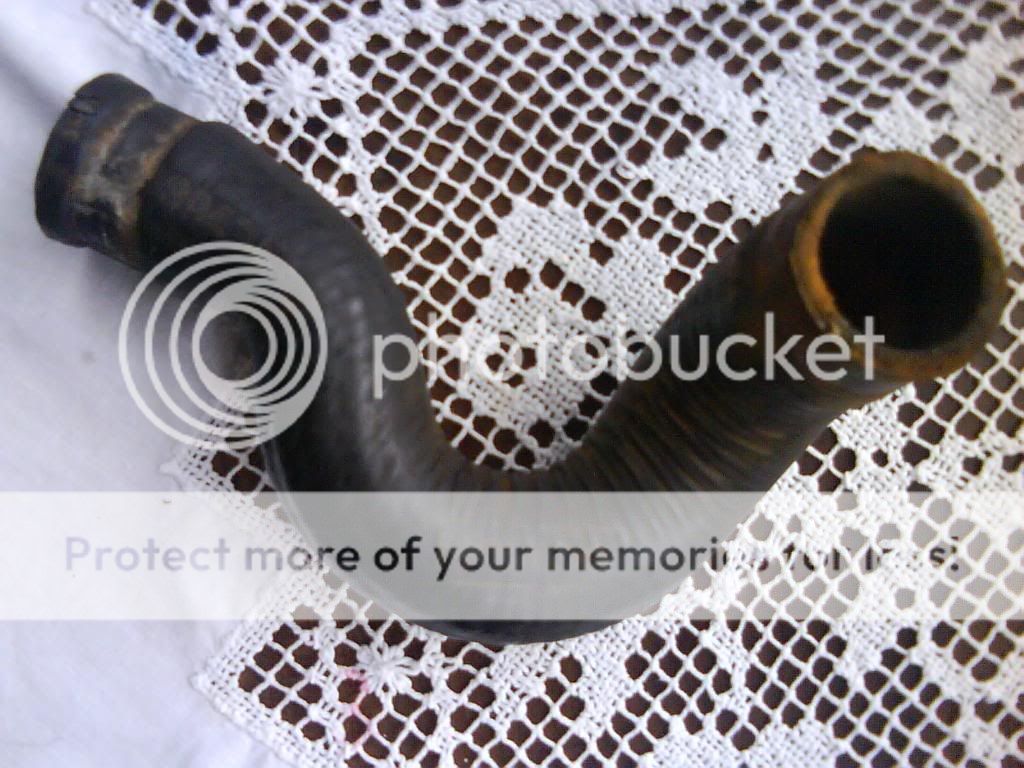

The first thing I did was fit a new top hose as the old one was split and it wouldn't have lasted much longer. It was stamped MOWOG so was probably the original!

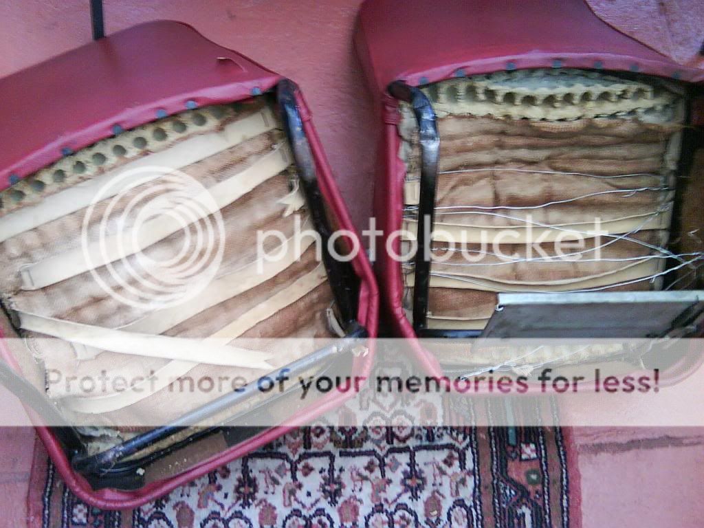

I also fitted new seat straps to the front seats, this is what they looked like when they were taken out:

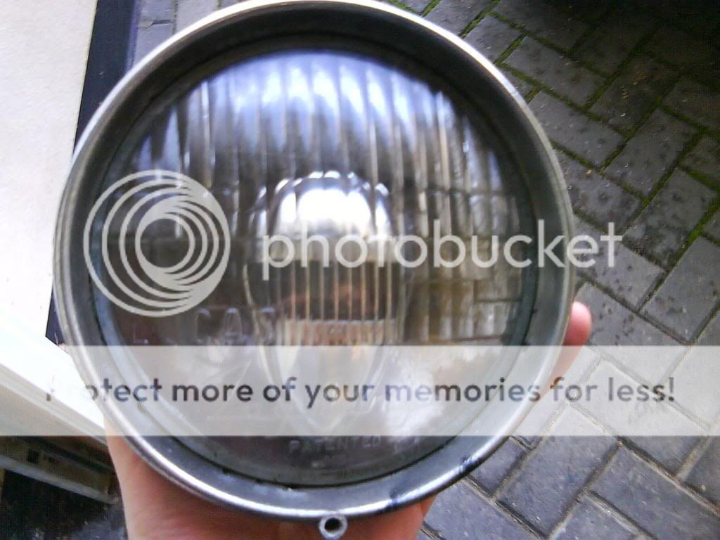

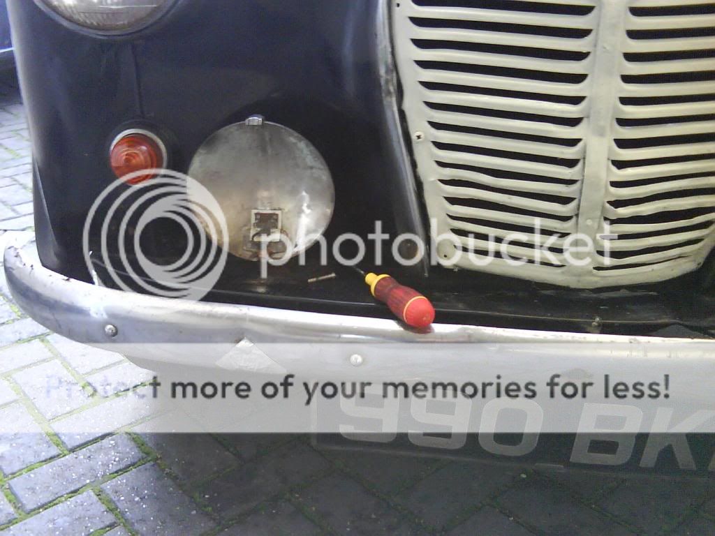

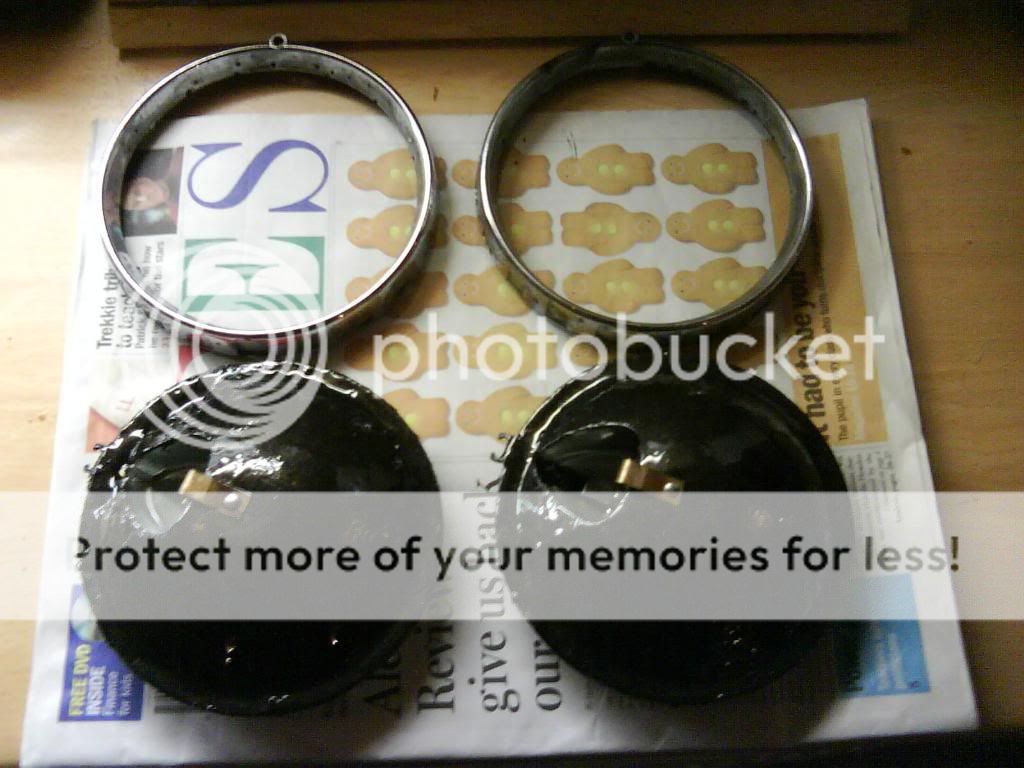

I have also been fiddling around with the front spotlights, they are period Lucas 'Ranger' and 'Fogranger' items, unfortunately they were very rusty inside and both bulbs had blown, I managed to get one working with a bulb Keef from the forum gave me, along with a couple of Lucas headlights, thanks again Keef Smile
Freshly painted Smile

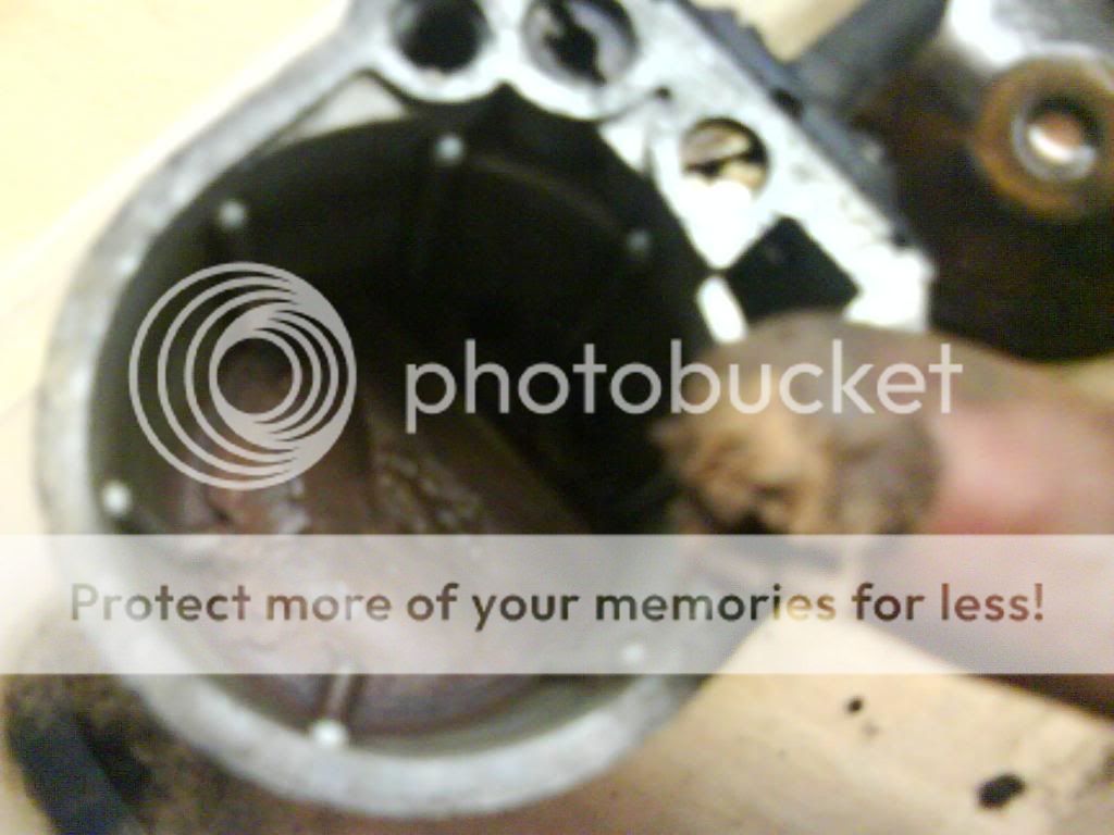

I then took it out on test, to reveal vastly improved brakes, still rather a lot of pedal travel, but much more powerful. Unfortunately the car now had a new problem, every time the revs dropped the engine simply died. The car has been cutting out occasionally at junctions for a while now, but yesterday it got worse. I recognised this problem instantly, blocked carb jets caused by dirt in the tank, exactly the same problem that I had with my blue A35 while on holiday in the summer.
Here's what the float bowl looked like when I opened it up!

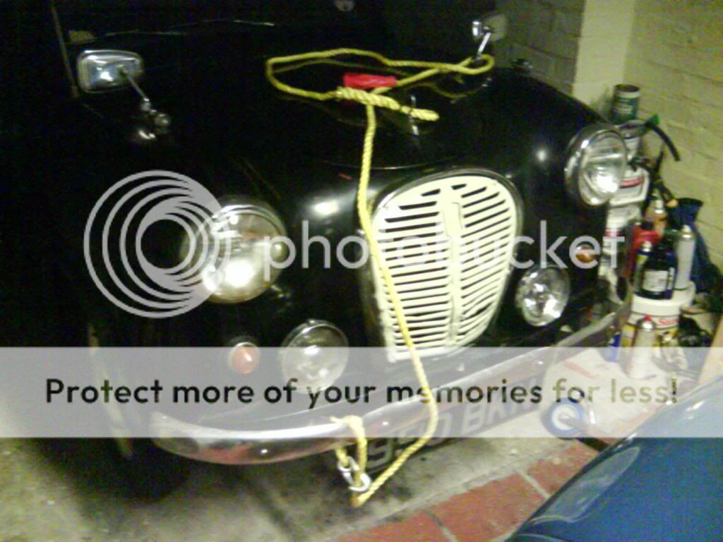

I was then heading home (dad was driving!) when he suddenly lost all drive and a tinkling sound started from the back end. Snapped halfshaft. Sigh. Luckily we were able to walk home, get the tow rope, then come back with the modern to tow it home.
The car is now sitting in the garage looking sorry for itself, meanwhile this is my new transport:
