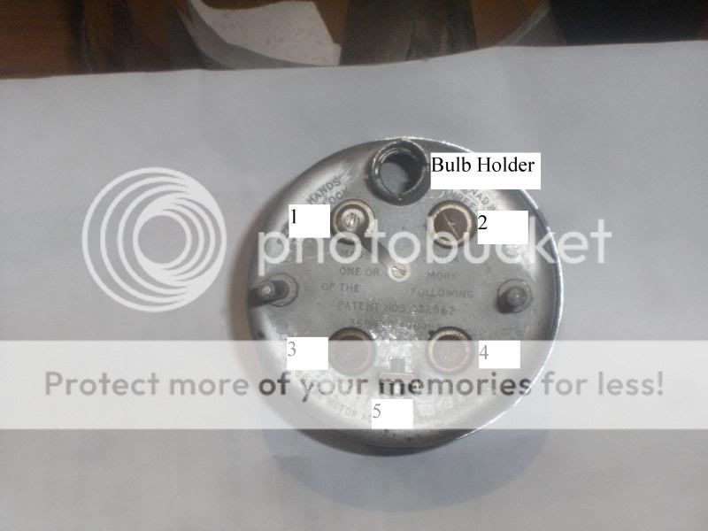

I just bought an original Ford Zodiac Smiths Clock on eBay which I want to use in my '57 Zephyr. The bakelite mounting is great, but the clock itself is positive earth and my car is now negative. I'd like to know how to convert it.
There's a lot of advice on this subject on the web but much of it is contradictory. I'm not interested in a mod which leaves the case or chrome bezel 'hot'. I could get a slightly newer clock which is -VE earth but I like the 50's detailing of the original.
All advice appreciated.

Hi Peter,
I haven't tried that because the terminal is labelled as negative and I've read of one going pop when simply connecting the other way around.
If you look at this post on the Cobra forum, there is a picture of the back of a clock very similar to my one. http://www.the289register.com/phpBB3/viewtopic.php?f=3&t=862

Let me reiterate from the website that I borrowed the picture from.
Remove straplink from term 1 then meter to the case. If isolated then connect +12v to term 1 and 0v to term 5. Make sure you have someone that has a good knowledge of electricals with you when you do this. Additional metering may be required. From the picture it looks as if it may be possible to remove all the screws on the back and remove the case for a visual inspection.
