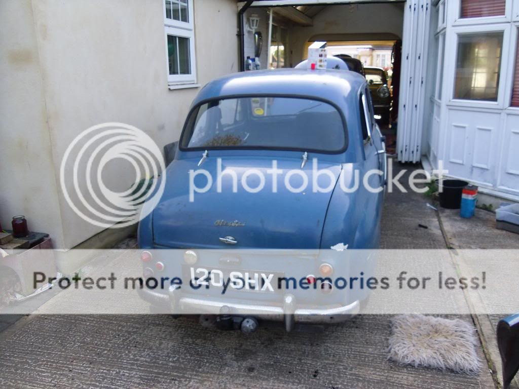

Last week I was browsing the Freeads section of the A30/35 site, as you do, when I spotted an advert for an A35 project for sale in Brighton. The man selling it had owned it since 1982, and started to restore it in 1995 when he had to stop work for various reasons, and it's been in the garage since then. It was delivered on a trailer this afternoon, and I'm happy to say, I don't think it's quite past it Wink

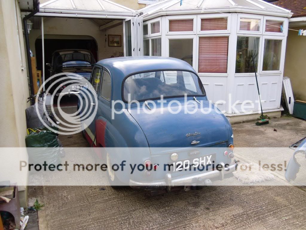

That's the original front wing, it's not bad but I haven't decided to refit it yet as (surprisingly) the fibreglass one is a good fit. There's plenty of repair sections with the car.

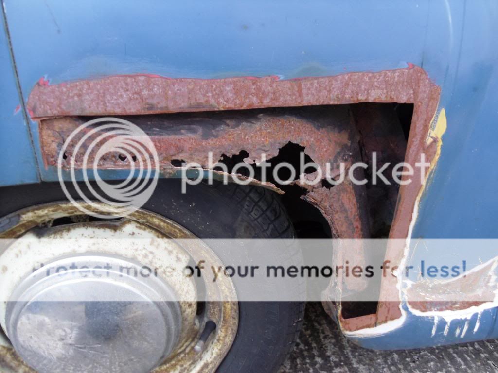

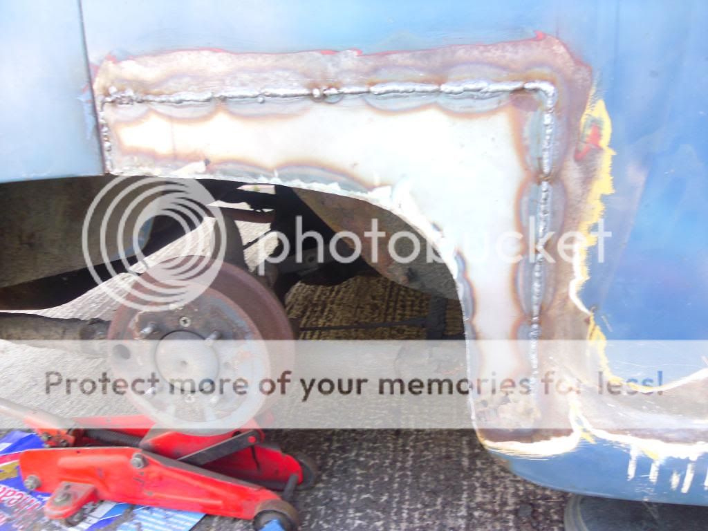

Anyway we moved onto the rear wing, which as you remember looked like this when I got it.
The previous owner had started to cut out the rust and had bought a huge repair section, you can see his marker pen lines where he was going to cut to fit it in the picture. But I decided it could be repaired without having to cut out so much original metal.

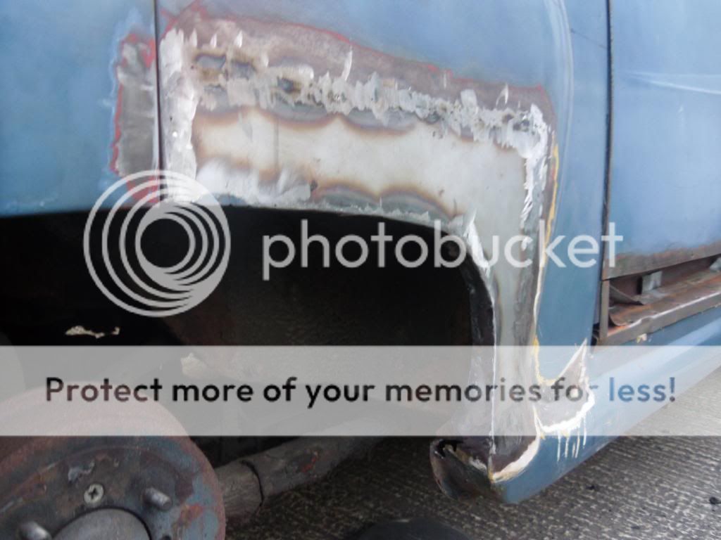

At the end of Monday it looked like this:

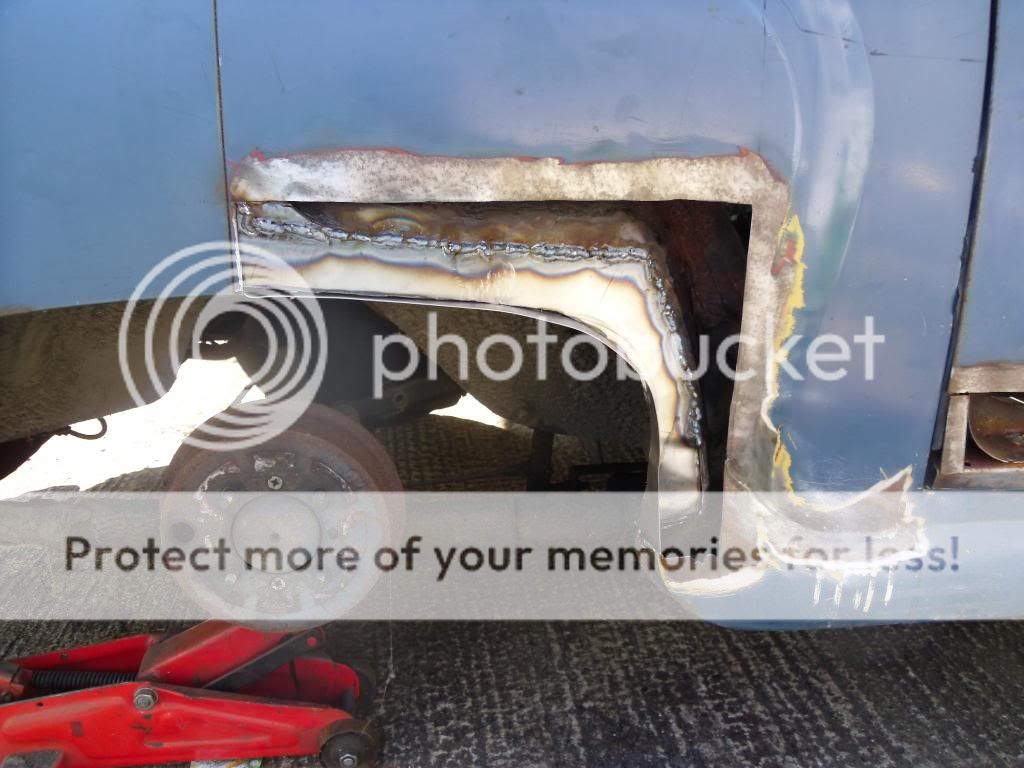

Tuesday saw the outer arch fabricated and welded in.

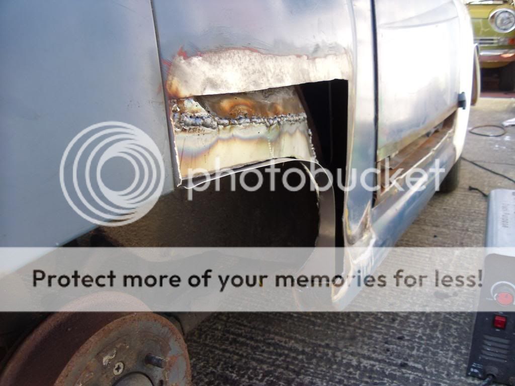

And here's some shots taken this evening, it's not quite finished but is nearly there. I'm pretty chuffed with the way this has come out considering there was so little left of the original metal to guage the shape.
