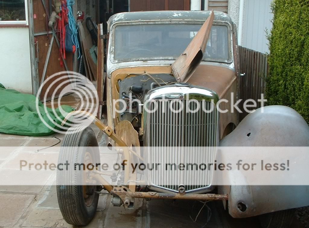

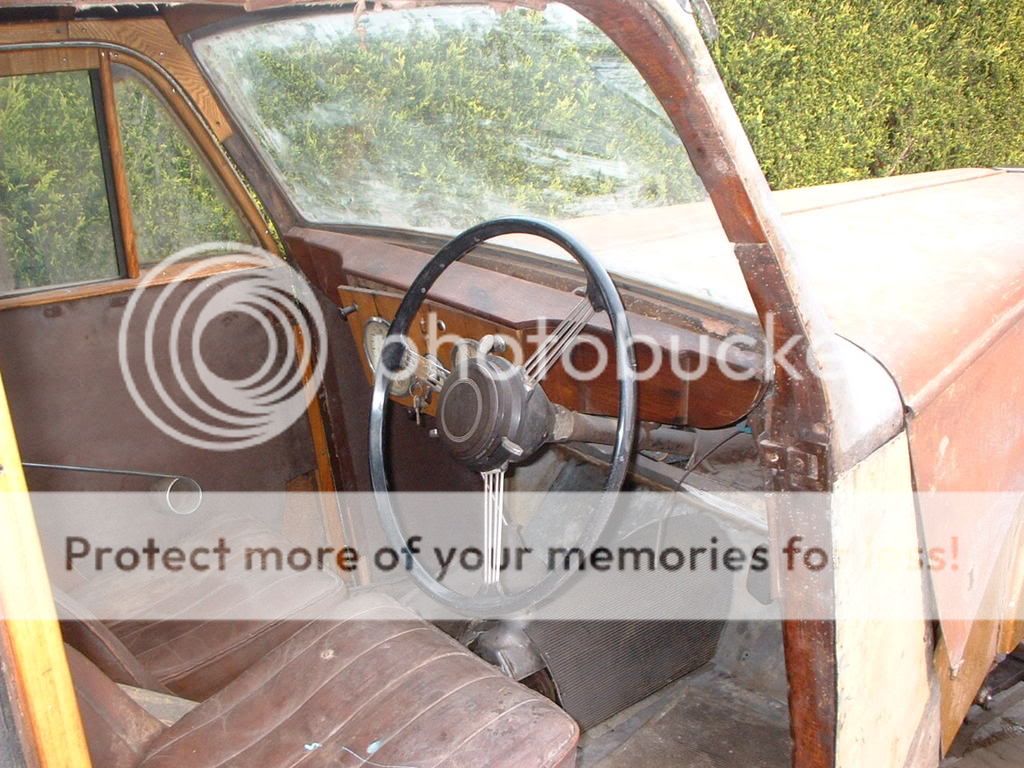

[img] [/img][IMG]
[img][IMG]
[img]
[/img][IMG][img][/img]
Hopefully Question photos attached. As you can see the previous owner (yes the only one) stripped her in the eighties, re-chromed everything, lights, trim, bumpers etc, then left it. Unfortunately most of the wood he'd replaced was eaten by woodworm as he left the original timber in the car.
a good spraying is the next thing on my list on 876 things to do!!
What do you think guys???

Wow what a wonderful project!! Smile
I think the trickiest parts to re-make would be the framing, has that suffered too or is the worst of the rot in the flat sections only?
I know of people who could restore the coachwork, but as you suggest it would cost a pretty penny to farm the whole project out to someone. If you could find a retired chap who is well up on woodwork and looking for something to do in his spare time, you'd probably get the job done for a reasonable sum (notwithstanding the cost of buying materials).
How about the leather interior trim, how well has that survived?
Thanks for posting the pics, great to see something really unusual like that!

Thanks guys. A few positive comments go a long way when you haven't a clue what to do with the old girl! The seats could possibly be used. I'm not into an immaculate concours finish myself, seats have a few holes and are dried out, but some hide treatment may sort out the worst, and the odd hole I can live with!
