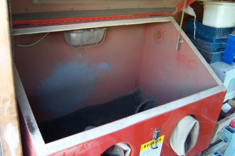

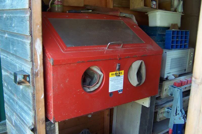

welshrover
Joined: 09 Aug 2011
Posts: 326
PostPosted: Tue Aug 13, 2013 10:15 pm    Post subject: Reply with quote
heres mine .its been invaluable for cleaning bits up on the imp i'm doing atm iv'e done 13" wheels in it .12" with a tyre on .
there is a extractor out let at the top corner which I put a shop vac running through a cyclone system it keeps the cabinet clear when in use .
Smile
