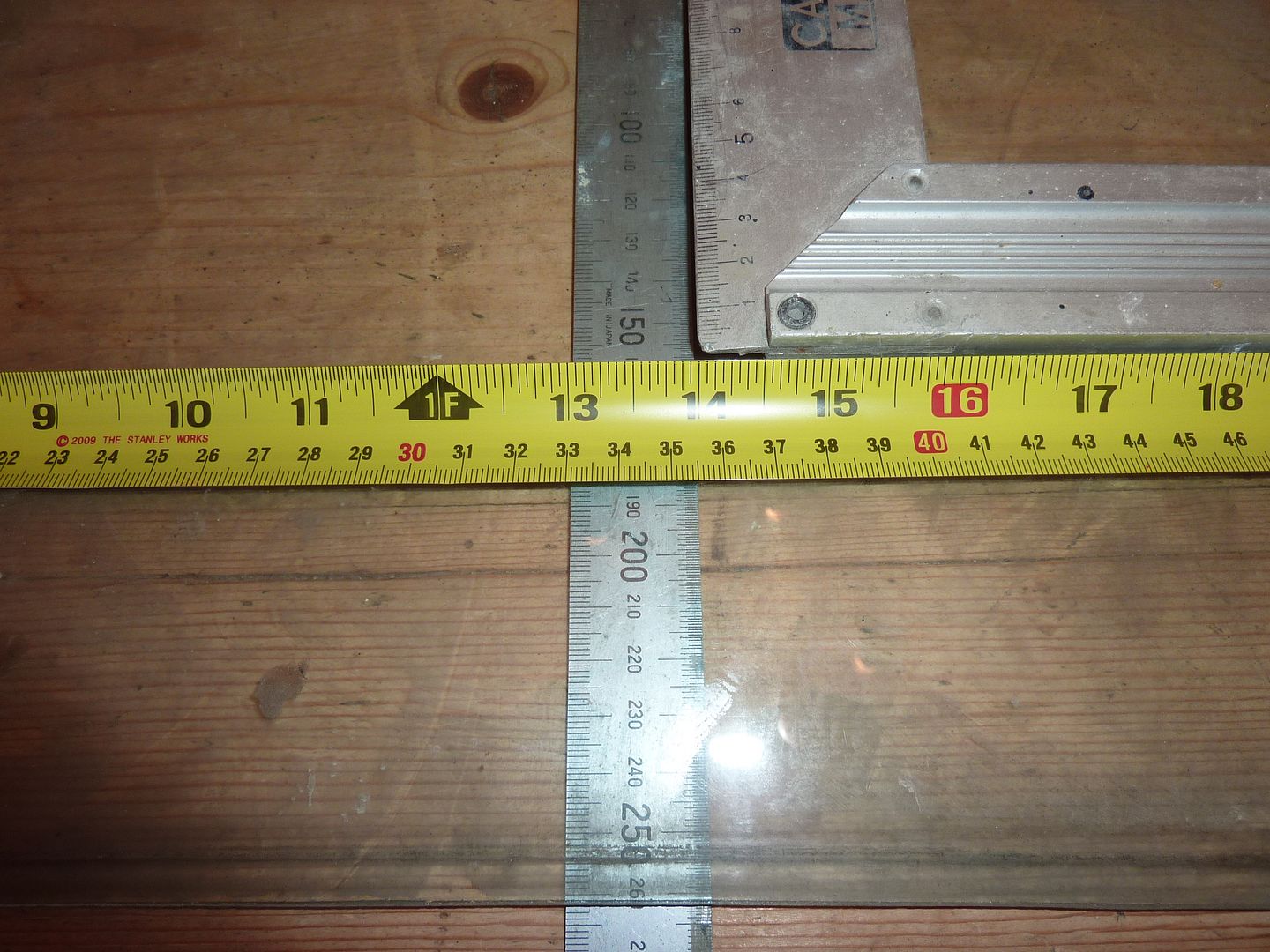

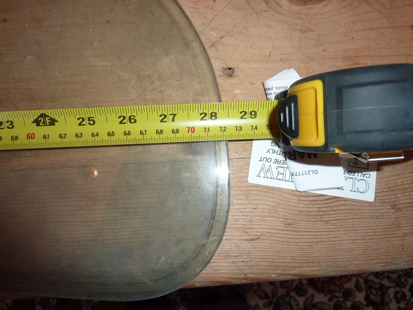

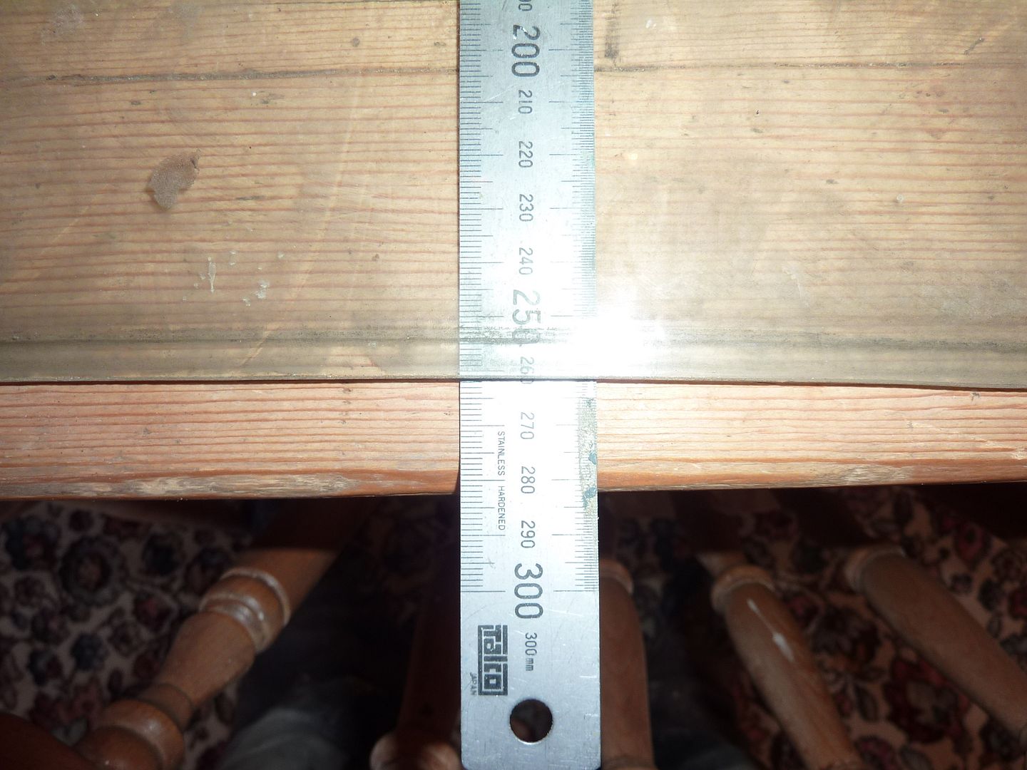

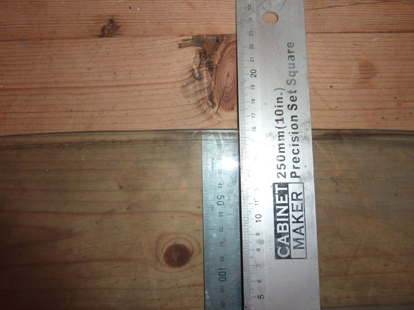

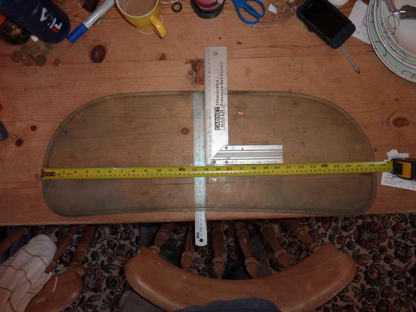

Hi Craig
Can you scale it from these pics?

Thanks once again for your help mate. I have taken a tracing of the window shape on a piece of 3mm MDF from the car of the outside circumference. And with you measurements you have provided, I merely have to enlarge the tracing by 6mm all the way round and should have my shape. When I buy the new rubber Ill fit the blank Ive made to see if that fits. Then I can cut the glass and have it toughened.
