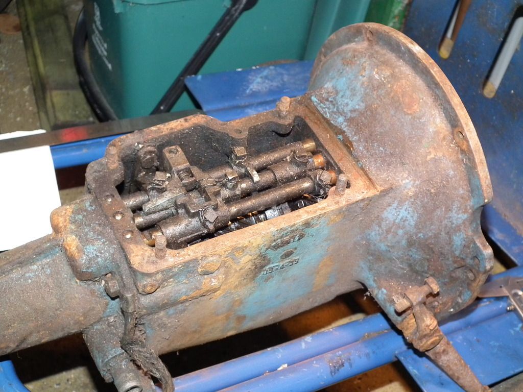

I aquired a gearbox that I was informed is a Morris 8 box.
I need a top cover and gearlever for it.

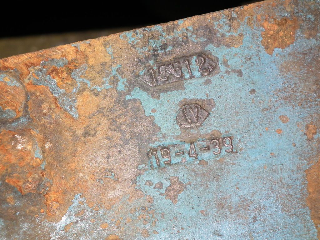

Anyway I started to clean it this morning and noticed that the casting figures might not be Morris.
The bellhousing bolt holes match the ford. rear mounting will need one fabricating.
Did all Morris gearboxes have 'MOWOG' cast on them.
The text is a series of numbers with W below them and below that what looks like a date.
Can anyone ID by these photos please

Hi Roger
This is a Morris 8 4 speed gearbox that I rebuilt:
Look the same to me Smile

Thanks Dave
Yes I agree the same,
Always thought Morris part had MOWOG on them that is what made me ask.
