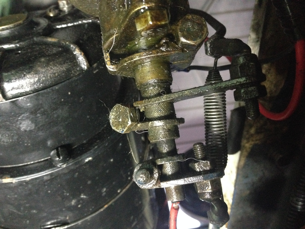

I had been out in the Dodge and was feeling good about the way the old car had been bounding along then quite unexpectedly the hand throttle lever became floppy and useless. I didn't know quite what had happened but I had visions of a breakage of some kind. Further investigation revealed nothing serious. The two levers for throttle and advance on the steering wheel are held in place by two little studs and a nut had come off one of them.
The method of concentric tubes passing through the steering column with operating levers clamped to their extremities is a common enough practise - as is passing the horn wire down the inner most tube. It was fortuitous that I had to remove the clamps to extract the tubes because I noticed the horn wire insulation had perished just at the point where it emerges from the tube and a short circuit was imminent. The easiest solution was to wrap some insulating tape around the break and refit the wire.
