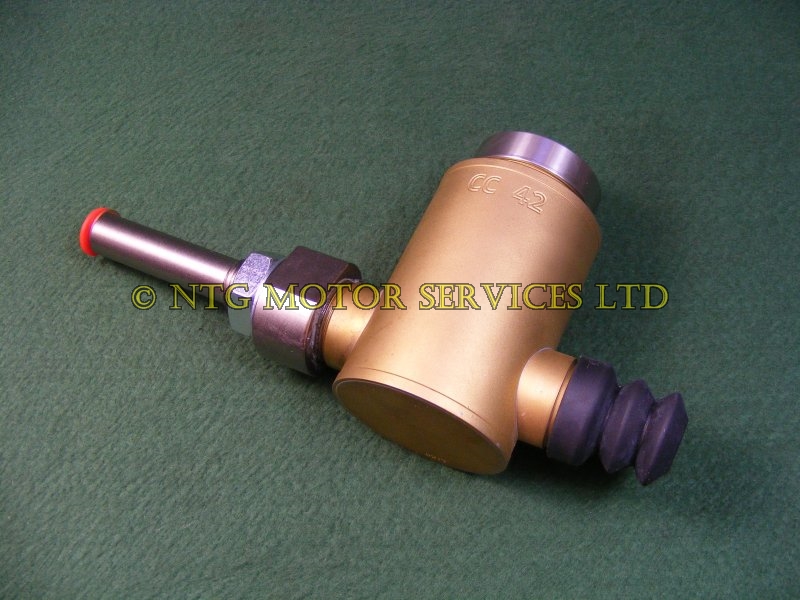

Hello all. My MG TC has the brake master cylinder under the floor (like a Morris Minor) and while the car is being assembled I would like to take the opportunity to add a remote fluid reservoir. This would make checking the level quicker and topping up much easier.
I have seen other owners modify the lid of the reservoir or (where possible) utilise a blanking plug. What I have in mind is to fit a T piece to the extension. As this is where the fluid enters the reservoir I can see no reason why it would not work - and be better than tapping into the lid - but I would very much like to know if I am missing something.
Please tell me now if it won't work rather than have me find out later by trial and error.
Obviously, the vent hole would need to be blocked and the lid properly sealed to prevent leaks but the new reservoir could be sited immediately above it on the engine side of the bulkhead.
Photo of my new master cylinder.
47Jag
