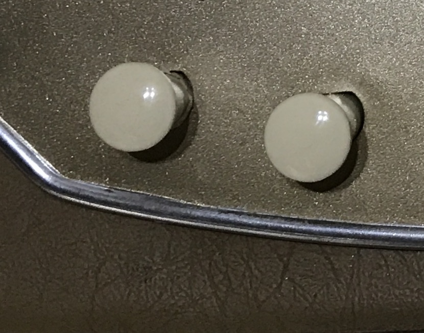

I need to fit cables to these knobs on my instrument panel. That is not really the problem. The question is how should I go about securing the cable/knob to the panel.
I only want some small discreet chrome bezels but I don't know where to find them. I will also need some means of securing the cable steadily to the panel and I am not having much luck there either.
Am I wasting my time trying to get all the bits together ?
Perhaps I need to hand the cables over to "speedy cables" or suchlike and have them sort it out.?
PostPosted: Sat Nov 21, 2020 12:44 am    Post subject: Reply with quote
Can we see pictures from side on without the panel?
I'm assuming they have a threaded outer.
A thin nut that fits the thread could have the hexagon turned off and then a slot cut across one face, this is fitted on the side of the panel we can see.
Many bezels look like that, then you just need another nut on the back of the panel.

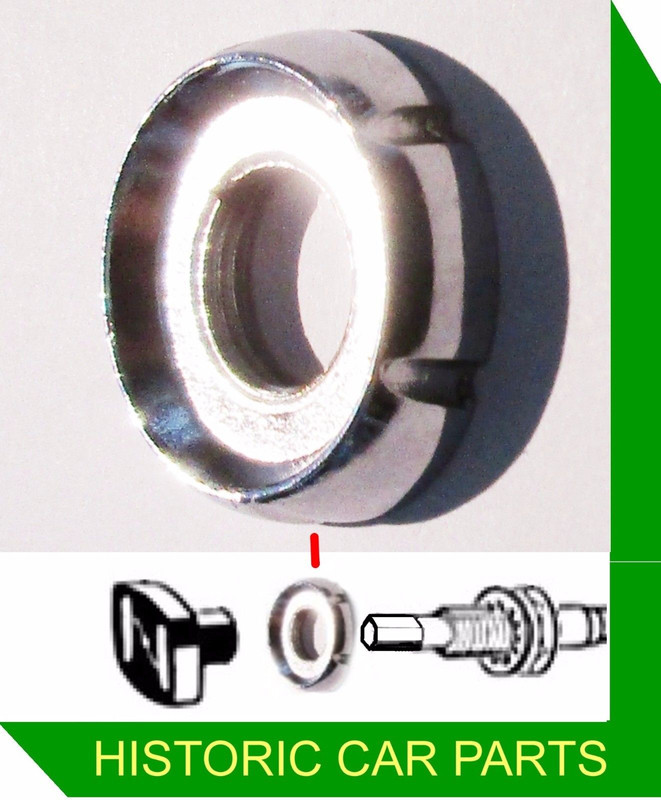

I think this is the sort of thing I have been looking for:
Trouble is it looks too "1960's /1970's Triumph" for me.

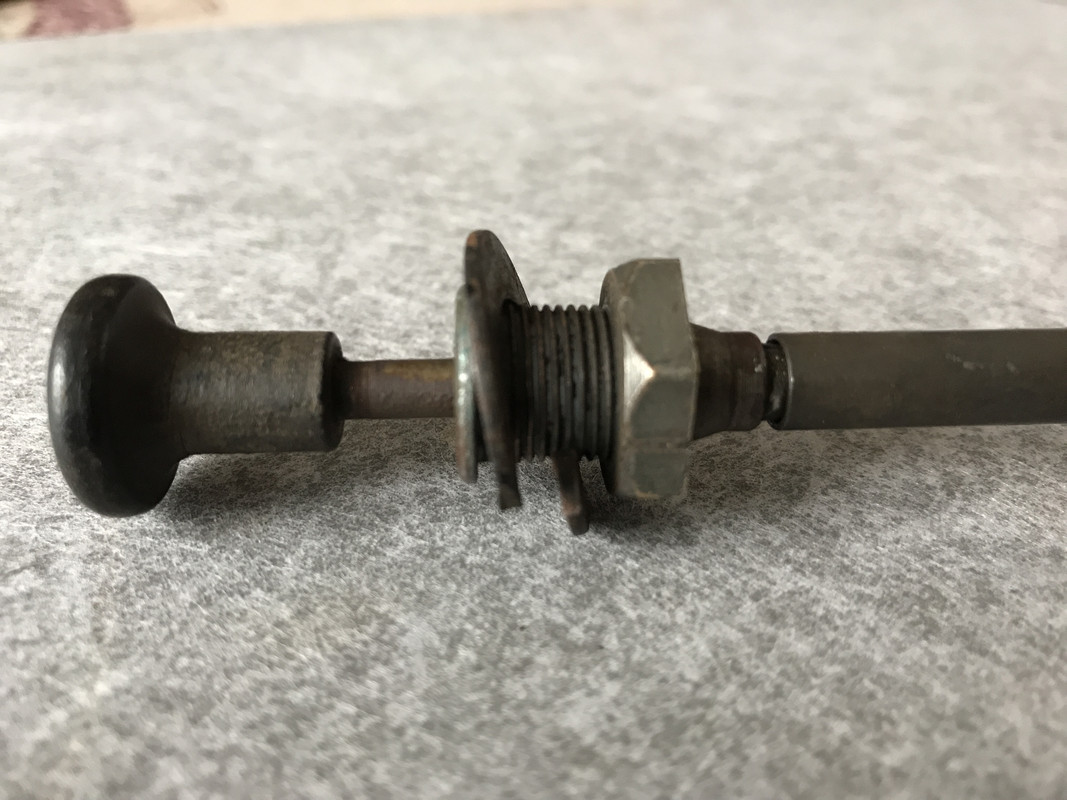

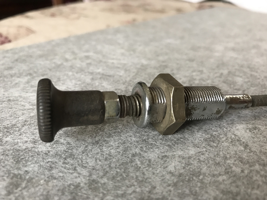

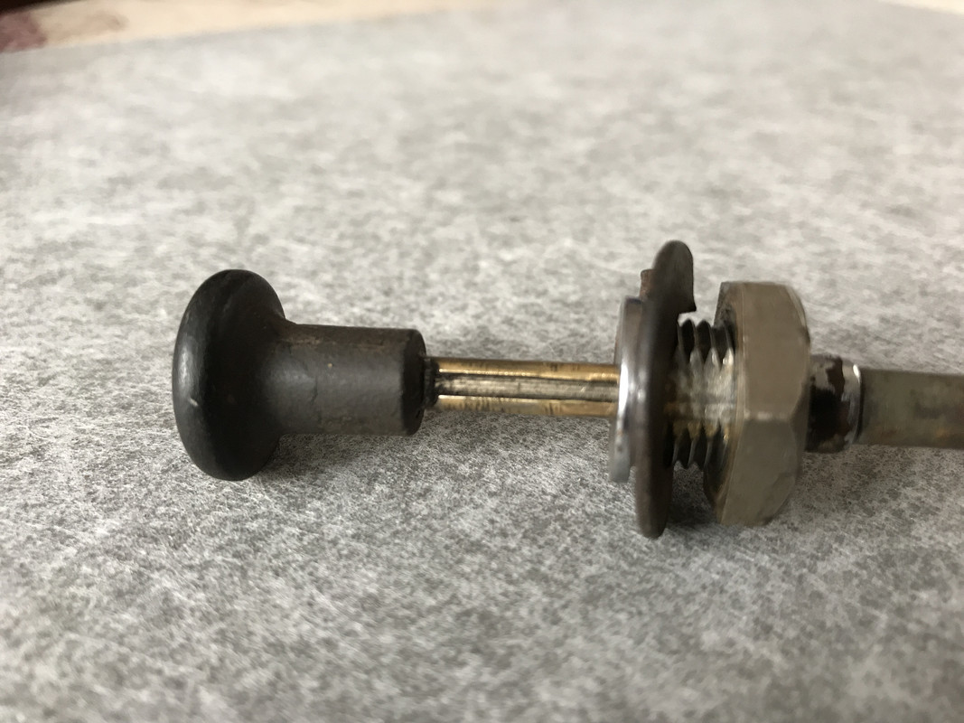

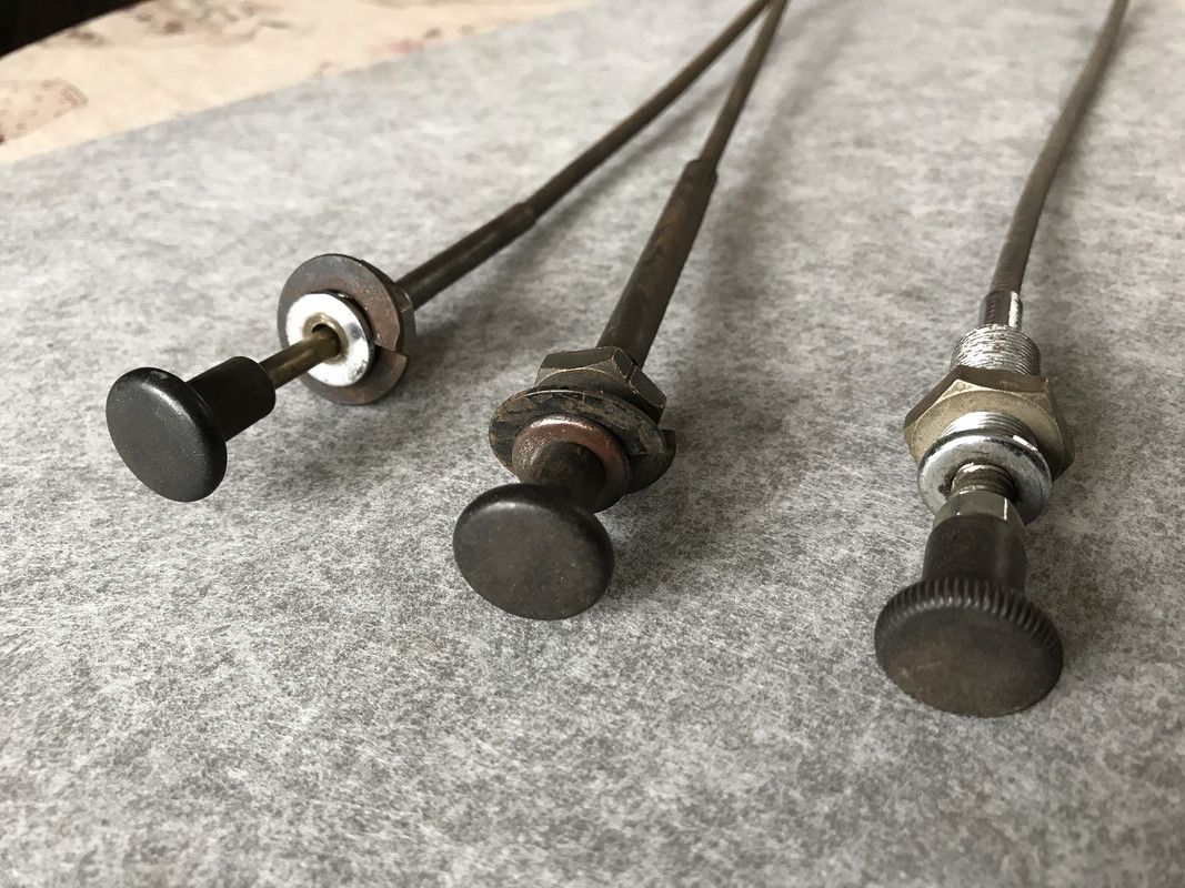

Here are the original TC cables. They are ALL different.!
1) The choke pull cable.
2) The starter pull cable.
3) The slow running twist cable.
What I have established is that the small chrome bezel to the dash side is an integral part of the threaded cable outer which is D shaped to fit the hole in the dash panel. ( Obvious really. ) and the assembly is held with a spring washer and half nut.
1) The choke cable is the worst condition of the three. It is stuck open but I might eventually be able to free it off. It has a groove in the solid first section which all choke cables seem to have but I can't remember what it's purpose is. The bezel is reasonable.
2) The starter cable operates freely and but the bezel part showing is rusty. This outer has a piece of brass tubing which I suppose acts as a stiffener. The cable would need to be shortened to meet the bulkhead mounterd pull switch.
3) The slow running adjuster is the best condition of them all with no rust although is sans a spring washer. It is an interesting cable that moves in and out as you twist the knurled knob (as opposed to pulling it).

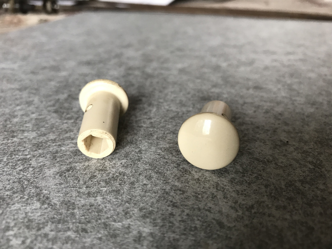

Unfortunately, the knobs are black and won't come off. I want to replace them with these:
I need to be very careful with the original knobs because although they don't necessarily fit in with my plans for the dashboard they are in reasonable shape and are like gold dust to anyone who is striving for originality. If only I could remove the knobs without damaging them!
The other option is to paint them but from past experience I don't think that a good outcome is very likely.
I could send the cables away to be restored/replaced but the originality will likely be lost....

I think what I will do for the choke and throttle cables is remove the old inners and replace them with new (generic) ones. If I can remove the modern knobs I can insert the new inners into the original outers with my cream knobs on.
With regard to the bezels (which as I mentioned are an integral part of the outers) the choke one looks O.K. and I can clean up/chrome finish the tired throttle bezel.
The slow running cable is more involved but fortunately I can unscrew the knurled knob. I will be cutting a suitable thread into the new cream plastic knob and fit it instead.
As the bezel on the slow running adjuster is in good condition, that should be job done.

Just to be awkward, the knurled knob thread on the cable is 5/16" x 26 t.p.i. which is BSC (cycle) so I have had to buy a set of taps to cut a thread in the plastic knob. I attempted to heat the cable and melt a thread into the knob but it was not a success. I will also need a 7.2mm drill which, with luck, I might have.
