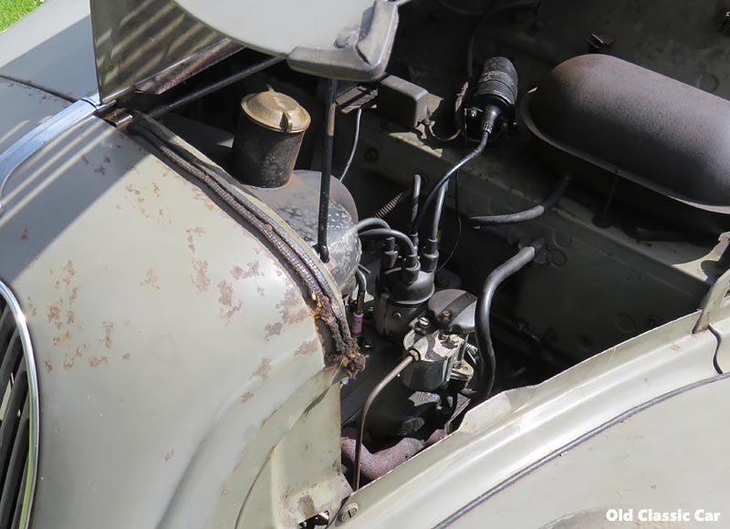

Yesterday I moved the Anglia for the first time in a couple of weeks, it wouldn't idle at all and on opening the bonnet, I was met with the stink of fuel pouring from the top of the carb. Two possibilities came to mind, a sticking needle valve and/or leaky float.
I took it all apart and it was immediately obvious that the float was full of fuel. Presumably the solder somewhere has given up? I left it in the sun for a while and you could hear it hissing as the contents tried to make a bid for freedom through the tiny pinhole, wherever it is.

It is strange this failure of floats. It makes you wonder what fails. Unlikely to be brass corrosion nor the tin or lead in the solder. Perhaps there was a small passage filled with flux?? Fatigue failure also seems improbable.
Posts: 1509
PostPosted: Fri May 28, 2021 10:08 am    Post subject: Reply with quote
As mentioned before I had the same problem with the floats in my TR4. First one started to leak a couple of years ago, the second I needed to replace a month or two ago. I suspect it has to do with chemical changes in the petrol formula.
Posts: 7759
PostPosted: Fri May 28, 2021 10:15 am    Post subject: Reply with quote
As far as I can recall, float failure was always a fairly common problem with old cars. I also think we may forget that Cleveland Petrol had ethanol which improved perfomance but perhaps had hidden side effects.
Posts: 2278
PostPosted: Fri May 28, 2021 10:49 am    Post subject: Reply with quote
As far as I can recall, float failure was always a fairly common problem with old cars. I also think we may forget that Cleveland Petrol had ethanol which improved performance but perhaps had hidden side effects.
Maybe? Maybe not? Not everyone had easy access to Cleveland fuels...
I'm more inclined to agree with badhuis ' suggestion. The components that make up today's petrol are very different from what made petrol in the 50's and 60's.
I doubt a branded fuel supplier would concern themselves with the effect their additives have on solder?
It is perhaps one reason why I will not use anything other than basic 95{?} octane leadless, aside from cost. All the superdoopah [higher octane] fuels have additives in them that were probably not considered back in the 50's?
We worry ourselves about ethanol!
Yet we ignore all the other tripe that goes into the most expensive, branded, fuels?
It is entirely possible that the leak was there along along?
Sudden proper usage of the car, using modern petrol, which evaporates much more readily at lower temperatures, maybe started an issue with the float? Also, as with modern circuit boards, it's possible there was a 'dry' joint, or partly dry joint, in the solder?
I wonder if someone makes ethanol-resistant plastic floats?

If you watch how people fill their carby bowls before starting their oldies, often by banging down the primer button as if it were a detonator. Perhaps that's the reason floats start leaking. After all, they are usually made of very flimsy thin sheet brass or copper.

My point was that leaking floats were a common place fault back in the day... along with poorly seating needle valves.
The thing is that Cleveland petrol back in the day would have had lead in it as well as ethanol, and I suspect that lead acted to inhibit corrosion in a way that was unintended and went unnoticed at the time because all petrol had lead in it. Modern fuel just has the ethanol with, most likely, very little in the way of corrosion inhibitors that might not be that effective anyway.

Put the float in hot water and the leak should "hiss" underwater and identify the point(s) of leakage.

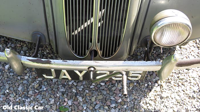

For a bit of fun I put together a short vid about the joys of starting handles, using the Anglia as a guinea pig while it was outside. I had thought of taking it to a show on Monday but then I remembered about a rallying event taking place elsewhere so we headed there instead.
https://youtu.be/Jn0Vxo_9TIQ
Handy things!

Took mine out to meet up with a mate in his 55 Bedford fire engine. Realised that at some point the previous owner has messed with the HT leads and one was completely destroyed inside meaning I was running on 3 cylinders. Quick replacement and an adjustment of the idle and now have a much nicer car to drive.
