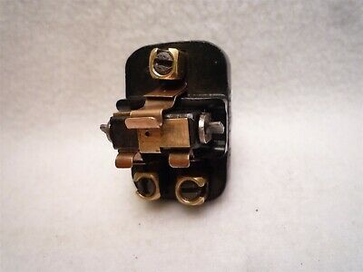

Please could someone explain how this switch works. It is a push button "tumbler" switch. I have observed how one set of contacts are activated and when the button is pressed another set are in play. I presume the single terminal is for an earth wire ... but I cannot think why there are alternate contacts when I would have thought just on/ off would be needed.
What could you use the alternate live for?

I suspect its a change over switch, looks similar to the dip switch fitted in the headlamp bowl of 60's British bikes?

Thank you Dave. Sadly I don't know much about bikes.
I have read that this type of switch was fitted to Standards and Daimlers but I am hoping to use one on the MG... although not as a dip switch.

I'm not sure it's a very useful switch for you because it's a little 'odd'!
It's just a change-over switch, like a foot-operated dip switch. My concern is that it doesn't tell you visually or by feel which position it's in.
If you fit a 2-speed wiper motor, I think it would be preferable to fit the correct toggle switch that goes with it - for one thing, the wiring will be simpler.

I was browsing The Lucas master catalogue this morning trying to identify some spare that came in a job lot, and came across the PS9 switch. Contrary to my previous assumption that it was a change over switch it appears that its a simple push on/off tumbler switch.
Its applications are wiper marked with a; W, Roof lamp marked with a H for Heater & Panel lamps marked with a P
The letter markings are pretty common across the Lucas range, so if do you use it the assumption to would be its going to turn the panel lamps on.
The knobs were availably separately, including unmarked and cream variants.
