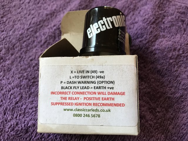

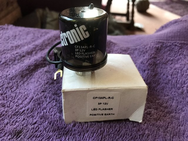

I found this... (forgot I had it)...It is LED / electronic / + earth.... so is there anything I need to know about fitting so I don't stuff it up?
Will it work with my normal bulbs?
MVPeters
Joined: 28 Aug 2008
Posts: 822
Location: Northern MA, USA
PostPosted: Mon Mar 14, 2022 10:41 pm    Post subject: Reply with quote
Yes. X = -12V from an ignition-switched source.
No. I doubt if it will work with incandescent bulbs. Check with classiccarleds.
Note: Some LEDs are polarity-sensitive so stick with classiccarleds.
I would decide now whether you go LED or not - you would be better off with a negative ground for a variety of other reasons, but you may be beyond that point.
2002 MINI Cooper 'S'
